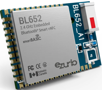

  2. Bluetooth module: BL652 Series Bluetooth v5 + NFC Module | Ezurio

The key components in the schematic are a linear voltage regulator, a Bluetooth module, and a motor driver. The purpose of the regulator is to convert the 6V input battery voltage from the J2 connector to 3.3V for the Bluetooth module. The motor driver is powered directly by the 6V battery supply. The Bluetooth module's 4 GPIO ports are connected to the motor driver to provide input signals for the step motor's movement. The motor driver's output ports are linked to the step motor via the J1 connector. Additionally, the J3 pin header enables the interface for programming the Bluetooth module.
The rectangular PCB size is 46 x 22 mm. It features a dual-layer stack-up, with all components soldered onto the top side. The bottom side serves as a solid ground plane. The right edge of the PCB includes a copper keep-out area to ensure optimal performance of the Bluetooth module's antenna.

Bluetooth Module Firmware and Programming Instructions
The file $autorun$.kaihdin_v5p6.txt contains the firmware for the Bluetooth module. Rename the file from .txt to .sb before use. For detailed programming instructions, refer to BL652 Series Bluetooth v5 + NFC Module | Ezurio
