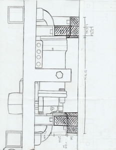

- Sketch original designs / Figure out measurements

Step 3: SolidWorks
- 3D Model all parts!
