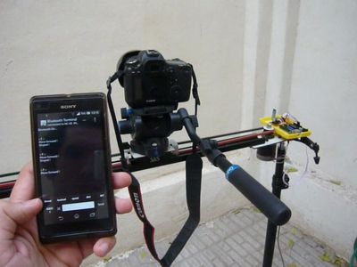

This instructable shows how to make a motorized camera slider. Actually we attach some additional parts to a manual slider to make it motorized and controlable by an Android phone. The idea behind camera sliders is to give you the ability to video "tracking shots" and time lapse videos that you can set up and execute in seconds. Tracking shots create a sense of movement, as if the camera was a passerby briefly filming the subjects on screen. They add professionalism to your work, give three dimensional sense of the scene and also a cinematic feel to any kind of scene you're filming. There are many cheap manual camera sliders in the market but the problem is that if you move the camera by hand the motion is not uniform and smooth, so making it motorized gives much better feeling.

We used "Bluetooth Terminal" Android App from NEXT PROTOTYPES. Commands were sent to the Arduino using a Bluetooth connection. For making it easy to control the slider we defined four buttons "Forward", "Backward", "Speed" and "Distance". Functions of these buttons are as following:
1. "Forward" move slider forward
2. "Backward" move slider backward
3. "Speed" adjusting slider motion speed (between 0.3 mm/s up to 37 mm/s)
4. "Distance" adjusting slider motion distance (9 to 81 cm)
Buttons "Forward", "Backward", "Speed" and "Distance" are defined in 'Button Preferences' section in setting of the app, they will send 'F', 'B', 'S' and 'D' to the Arduino respectively. For adjusting speed and distance you should just send a number between 1 to 9 from app.
