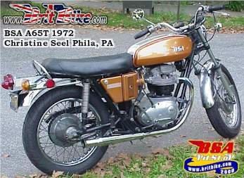

I didn't want to tear apart a camera tripod just for the bolt and I couldn't find the right size in my tool box. I had these license plate bolts in one of the drawers and they are the same size. They were on a 1972 BSA Thunderbolt my wife used to have. I thought it was appropriate considering the history of BSA Here's a little info on BSA.
