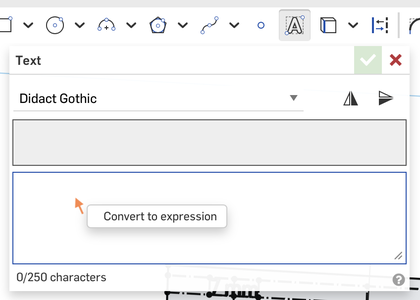

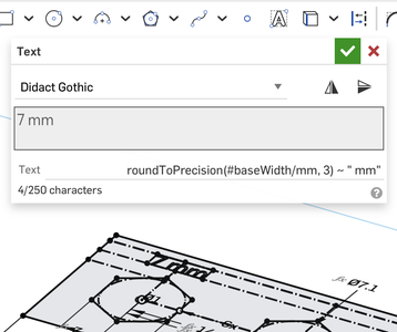

Place Holes
In your favorite CAD program, sketch the hole patterns and critical measurements. In my design, I first placed the hole patterns with the origin in the center, and then I drew the shape of the bracket. You may decide to do it in a different order.

First, create a text element in your sketch.
Inside the text dialog, right click on the text entry field and select "Convert to expression."
To show "7 mm" in my sketch, I have a variable #baseWidth set to 7 mm. This is the expression:
roundToPrecision(#baseWidth/mm, 3) ~ " mm"
If I want to use this fit test tool for another size of nut, I just have to change the value of #baseWidth. The labels will automatically update.
See the documentation for more details.
