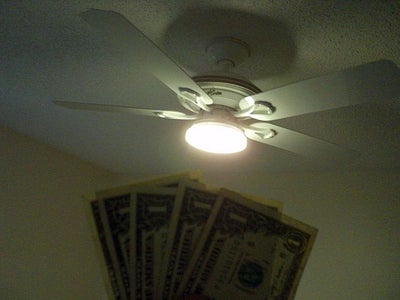

Introduction: Mount an Inexpensive Led Hall Lamp to a Ceiling Fan
I'm replacing older ceiling fans in my home with better units, and when I priced modern LED lighting accessories for them I found the retail pricing far beyond what was reasonable and proceeded to source my own. This is therefore, not an Instructable on installing or hanging a typical ceiling fan- there are plenty of posts for that, this one will focus solely on modifying and adapting an inexpensive imported hallway LED lamp to answer this need.

I believe all fans come with extra in- place wiring to facilitate installing an under-mount lamp, but am not sure they all use the same color code to identify them, so that is something to be determined during the adaption process. Mine were readily found with labels and so connecting them to the LED driver was an easy matter of strip, solder together, heat shrink tube insulate and done. I gave each unit a live test to be sure they worked as I didn't want to be at the top of a ladder and have to troubleshoot an unlit fixture.
Step 7: Parting Thoughts
I'm reasonably certain that with little change save private labeling, these fixtures are essentially the same design as is sold by the fan manufacturers at a much more expensive markup, in any event it was an easy modification and I'm now enjoying savings of both initial cost and operating expense.
