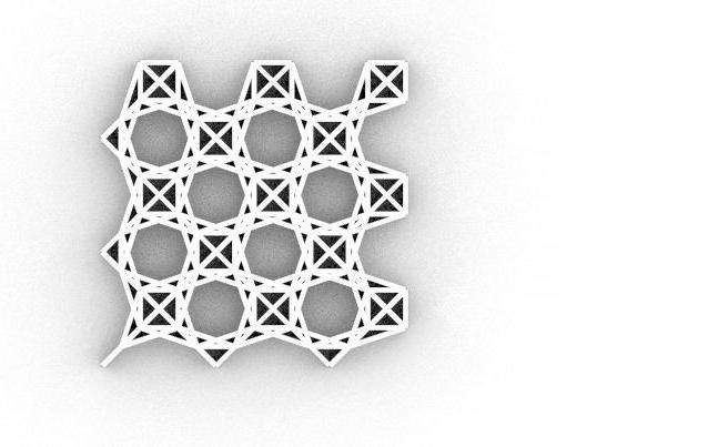

The plastic container of the device has been measured and recreated in Rhino. The grasshopper design is a parametric system that can adapt to several scenarios, with different dimensions. The base of the pod however has to be rectangular or circular to fit the design.
Step 2: Boolean Operation
A boolean operation inside Grasshopper helped to make the print more efficient by using less material and reducing printing times by 70%. The print took approximately 1 hour and 15 minutes in Standard Quality. Furthermore, by performing a Boolean operation between the base and a circle, the design can also be used as a cupholder!

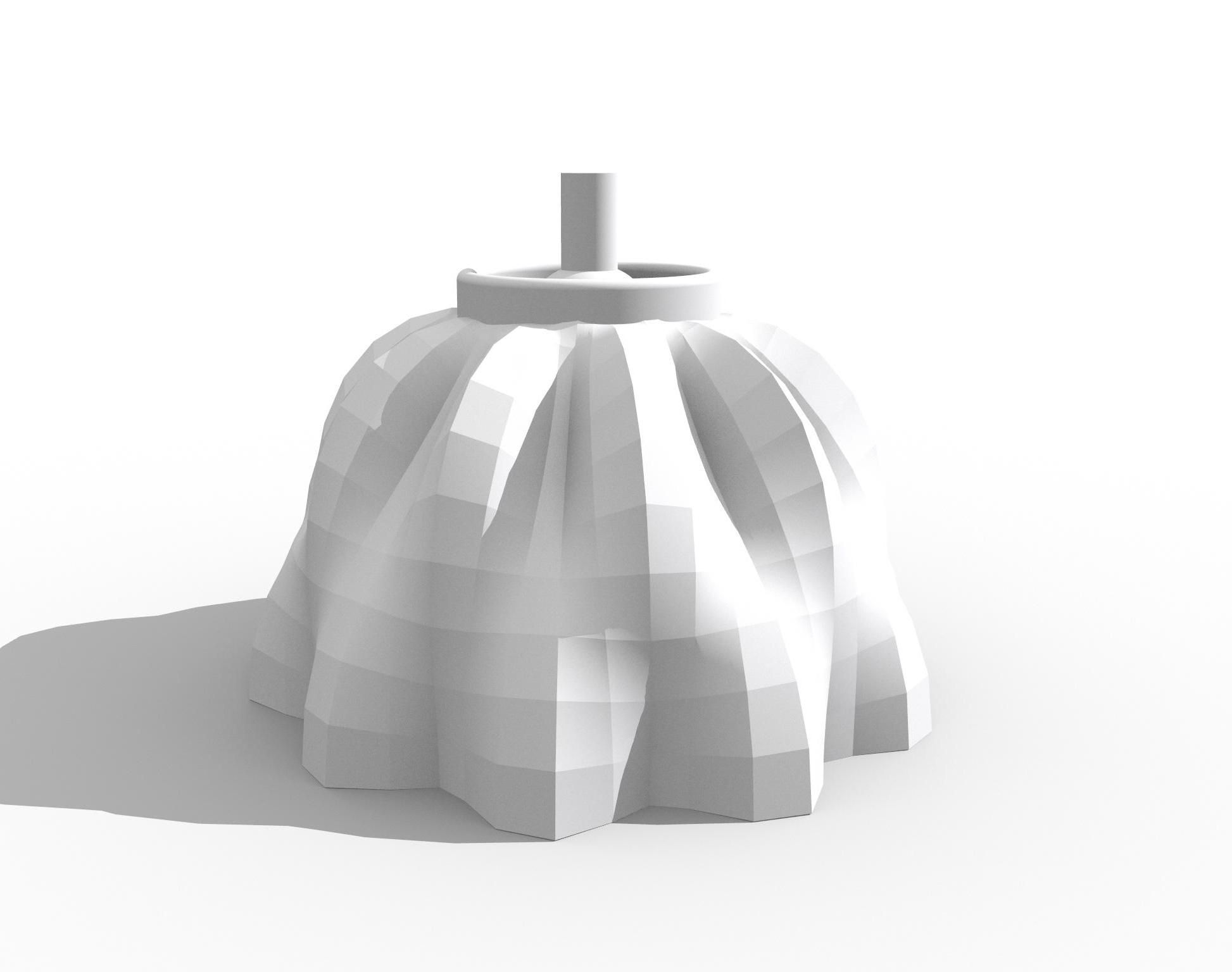

Step 3: Test Different Operations
Voronoi operations have been tested in Grasshopper, but the output failed to achieve the desired result. Voronoi seems to be addressing larger objects that justify the aesthetic for such an approach.
