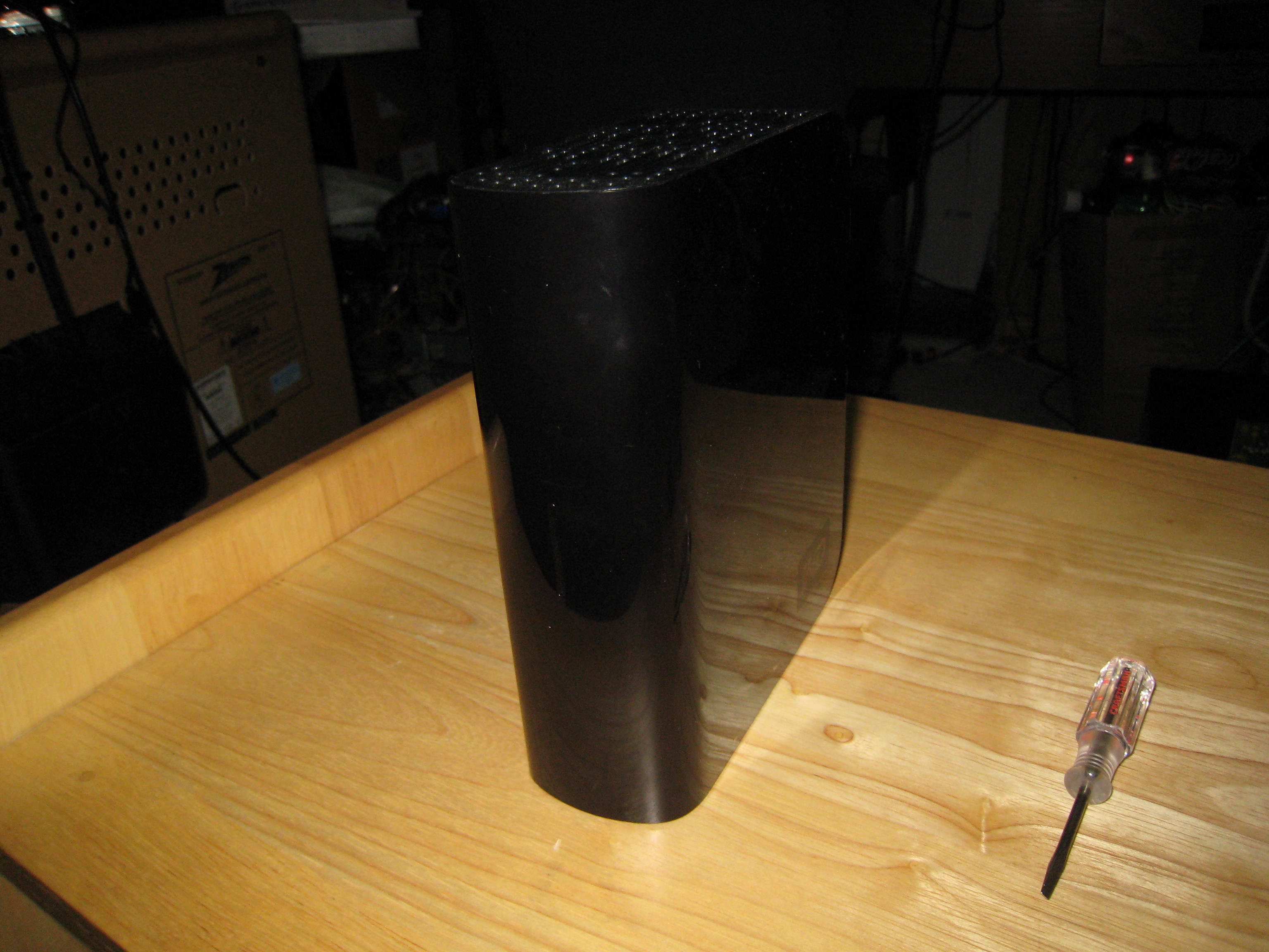

If you are thinking about setting up a home theater with decent speakers, you will probably have to mount them on the wall. I will show you how I mounted my four satellites on the wall. These speakers are from the Logitech Z-5500 set, but nothing in here is too specific to them. I did all of this for less than $5 of supplies.
