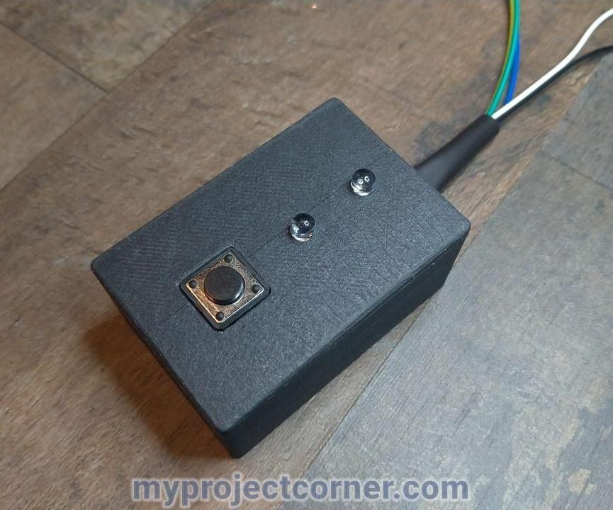

Step 1: Drill Box Lid
Using a 22mm wood drill bit, make a hole in the lid of the plastic cable box.
Step 2: Connection Cable
Make up the cable to connect the sensor box to the Raspberry Pi. I am connecting to an existing Pi which is around 3 meters away.
Cut 3 female/female Dupont wires in half, and solder to each end of the length of cable (making sure the colors correspond at each end). Protect from short circuits with heat shrink or electrical tape.
Step 3: Attach the PIR Dome
Using a hot glue gun (or just glue), fix the infrared sensor to the lid. Pass one end of the cable through the side hole, and connect to the sensor.
Step 4: Finish to Motion Sensor
Connect one end of the cable to the PIR sensor, and close the box.
Step 5: Connection to the Raspberry Pi
Connect
PIR Sensor to Raspberry Pi
- VCC to 5v (pin 2 or 4)
- GRD to GRD (pin 6 or 9)
- OUT to GPIO4 (pin 7)
