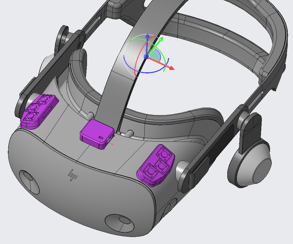

The code was created for the need of easy mouse control with VR headset. It's updated version of original one.
