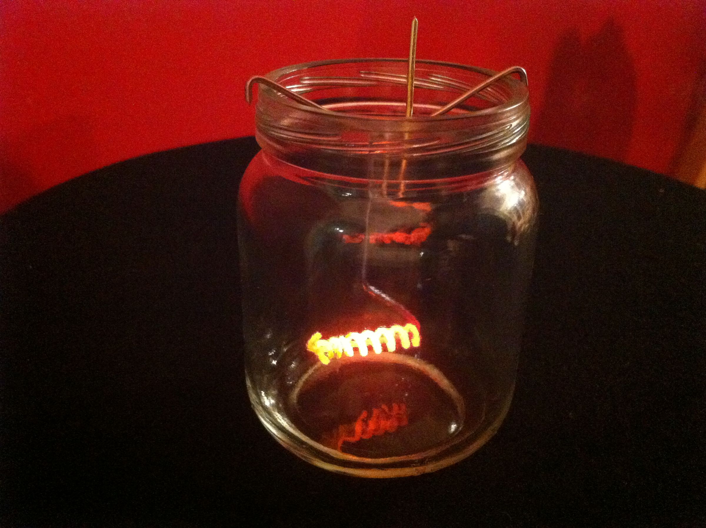

Step 5: Assemble a Bubble Module
Each Entropy Module is assembled quite easily. The photos show how to wire up a simple 120 VAC power supply. Observe standard precautions when working with dangerous electricity. When the Entropy Module is finished it should operate like this:
Step 6: Attach Mouse Sensor to Bubble Module
I use a black elastic band to hold the mouse sensor to the bubble light. The mouse sensor has a small pinhole opening. This pinhole is placed against the glass of the bubble light. The motion of the bubbles is interpreted as movement by the mouse. If you plugged the mouse into a computer you would see the cursor on the screen wiggle around randomly.
