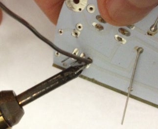

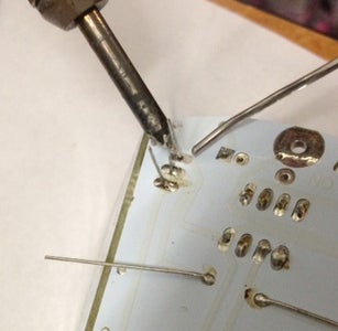

Step 4: Preparing the Main Solder Pads
Load these pads up with a lot of solder.
Step 5: Assembling the Main Board, Side Boards, and Battery Board
Use the masking tape to help hold the boards together. Point the Battery Connector towards the wider side of Herbie. Once they are stable, heat up the solder in the main pad pairs to connect Herbie.
Step 6: Finish Soldering the Remaining Connections
There are 12 more places to solder to connect Herbie's body.

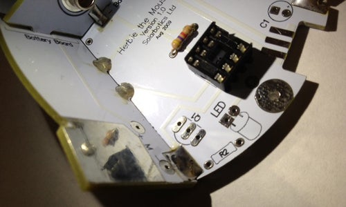

Step 8: The 8-Pin IC Socket
Install the IC socket at the IC1 spot. Make sure you're using socket and not LM386! Note the notch position! Use picture number 1.

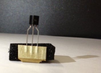

Step 11: Transistor Installation
Bend transistor down 90° towards the flat side. Put it in location Q1so its close to the board where the straight line is printed.

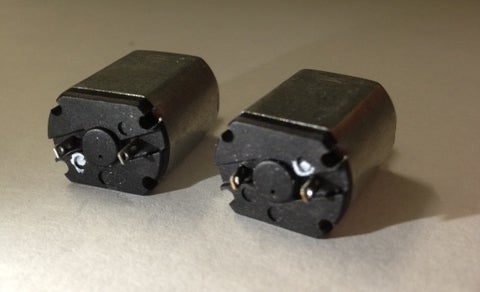

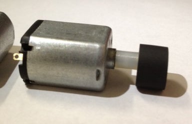

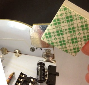

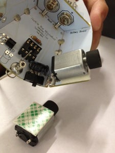

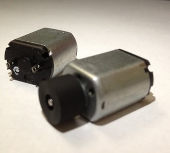

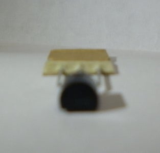

Step 17: Preparing the Motors
Put the wheels on the motors. Wipe motors with alcohol or window cleaner so that DSST sticks better. You don't want your motors falling off! Cut the tape to fit your motors. Before putting tape on, make sure white dots are next to each other. Solder wire clippings to the motor leads.

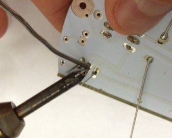

Step 18: Mounting the Motors to the Herbie Body
Align the black part of the motor with the top of the pad. Put the wire clippings through the - M+ .
