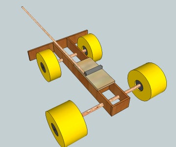

Step 1: Schematics
Theses images are the schematics from my original and final designs.
3d models are available here (uses Google Sketchup)

Step 3: The Body
After clamping the mousetrap, use pliers to take out everything but the spring and the lever arm on the mousetrap. Cut the lever arm (see picture).
Drill 1/4" axle holes 3cm from one end and 5cm from the other end of the 10" lengths.
Assemble as shown with wood glue or epoxy. 1 3/8" lengths should go under either end of the mousetrap and one should be centered under the mousetrap. 7" and 1 3/4" lengths should be centered on both ends of the car with the 7" length 5cm away from the axle hole. The mousetrap arm should face the front of the car (the 7" piece)

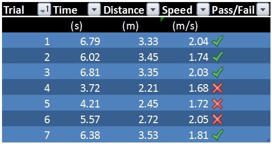

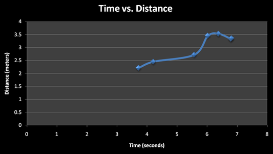

Pull back the mousetrap arm and turn the back axle backwards, after slipping the loop over the wing nut. Set the car on the ground and let it go.
Below is a table of the data and a graph of the data from my home testing.
