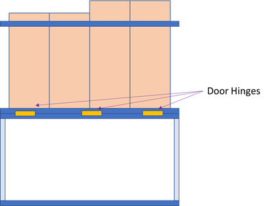

1) Mount solar panels to 2 of 2x4x92 (flush at bottom). I just drill through solar mounting wall and screw from the back.
Step 2:
2) Next is to build a base. You need 3 2x4 … cut 1 into 2 even parts and assemble (as below). Pay attention to the length (because it is same length as studs mounted on the panel)
Step 3:
3) Mount the 3 door hinges to base and the solar panel (sorry I don’t didn’t take picture)
Step 4:
4) Mount 2 L bracket (using 4 lag screws) to top stud
Step 5:

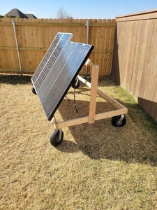

5) This step (best with 2 people). Unfortunate. I did by myself.  Cut the last 2x4 to “design” length. This design length is “angle”. So if you have 2 people, one hold the solar panels and other measure the length and cut. I struggled but manage to find the approximate length 39” … So I cut the 2x4 to 39” … then drills 2 holes at 2 ends.
Step 6:
6) If you do by yourself, just mount 2 short bolts to the top 2 l-brackets (use outermost holes). Use them to support the panel. Then continue to drill to 2 hole to side of base.
Step 7:
7) Once done, remove the 2 long bolts at bottom and lay the panel face down, and flip the bottom of base up… and mounting the 4 wheels
Step 8:
8) Once the wheels are mounted, lift the base up and mount the 2 long bolts back.
Step 9:
9) Once every is mounted…. Just flip the solar panel up … done.
