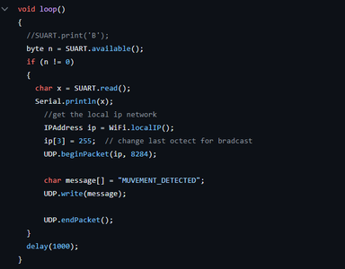

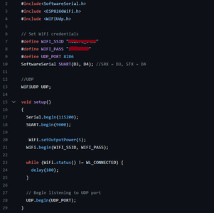

Step 3: NodeMCU Code
The NodeMCU code is a little bit more complex but not much of a deal. We have been through the setup in previous tutorials, We set the credentials and begin. We added the SUART serial software pretty much the same as the code in the Arduino. The loop waits until a signal is read from the SUART. Once available, we read it and print it. Bear in mind you can remove this, is just for testing. Finally, we send a UDP package with an alerting string.

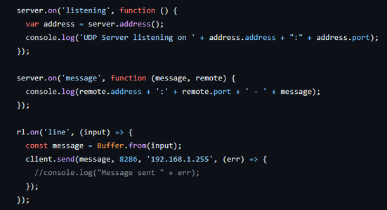

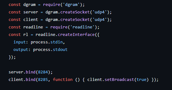

Step 5: UDP Client Server Test
Once you have it assembled you will need to test it. So you will have to revisit our UPDClientServer. But bear in mind you can develop your own UDP server in any language or just find one out there.
