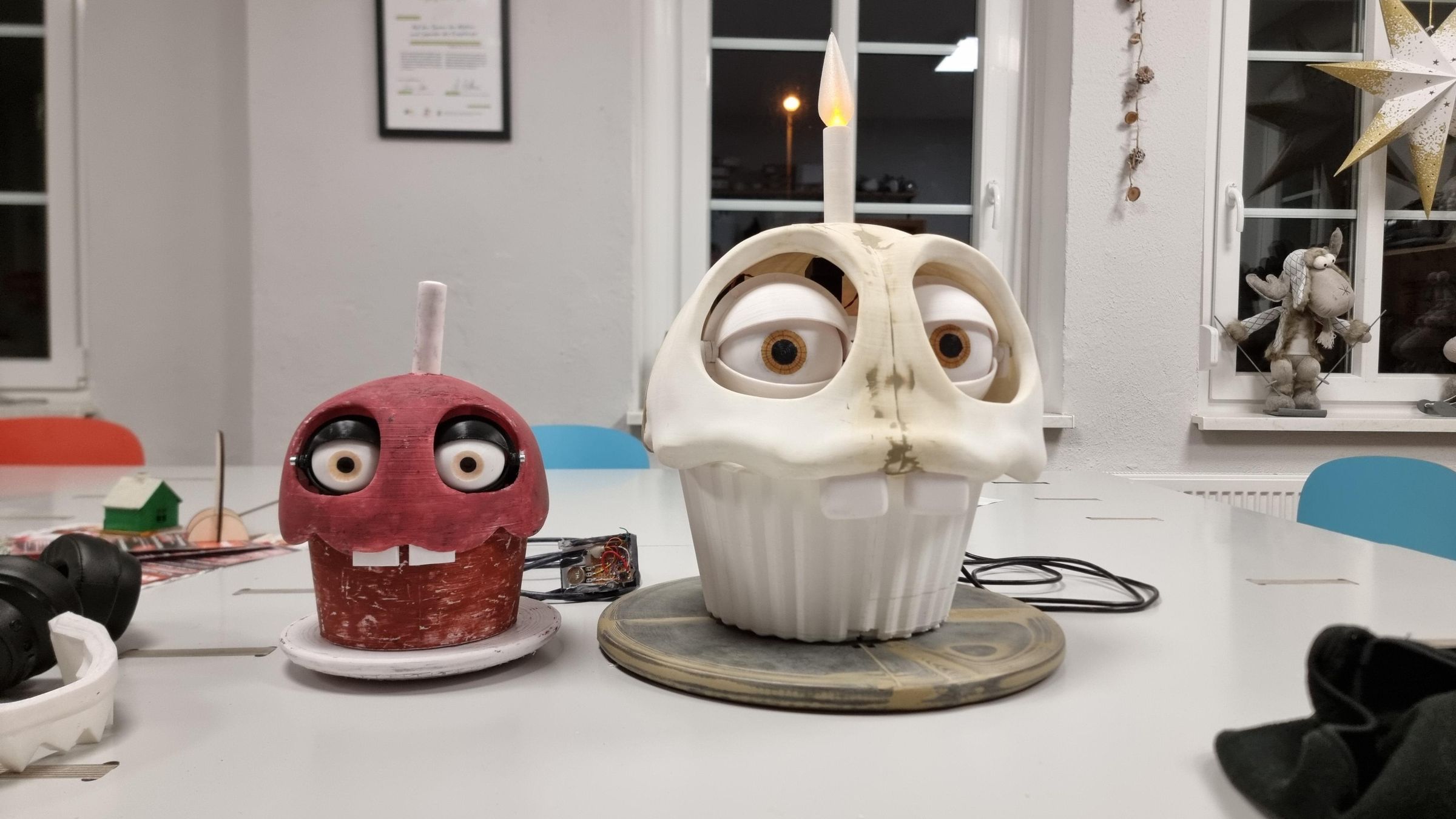

Introduction: Movie Design Earmech
This Instructible is for helping you assemble your FNAF Movie Earmech Replica

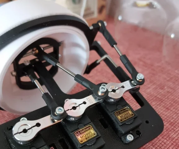

  2. 2 Servos per Eye (QY3240MG)
  3. M3 Screws (M3 Set)
  4. M3 Countersunk Screws (CS M3 Set)
  5. 2 Servo Horns per Ear (25T Servo Horns&Round Servo Horn)
Step 1: Assembly
This Video Shows u every Step of assembling my Earmech

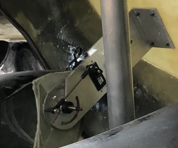

For Stability i Recomend making the Piece "Ear_Rod_R or Ear_Rod_L" out of Aluminum
