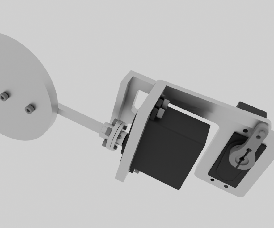

Step 1: Assembly
This Video Shows u every Step of assembling one of my Eyemechs
As you can see I used Threaded Rods and Ball Joints to connect the Parts needing to Move. u will need to cut those Threaded Rods in the Correct Lengths.
In the case your using the 100mm Eyemech i made for my Chica Cosplay then the Measurements per Eye would be:
Eyelids:
  1. 48mm (bend 45°)
  2. 21mm
Left and Right:
  1. 35mm
Up and Down:
  1. 33mm
In the case your using the G Freddy Eyemech from my Christmas Release then the Measurements per Eye would be:
Eyelids:
  1. 45mm (bend 45°)
  2. 20mm
Left and Right:
  1. 33mm
Up and Down:
  1. 31mm
In the case your using the 83mm or the Nightmare Bonnie Eyemech then the Measurements per Eye would be:
Eyelids:
  1. 34mm (bend 45°)
  2. 15mm
Left and Right:
  1. 25mm
Up and Down:
  1. 22mm
