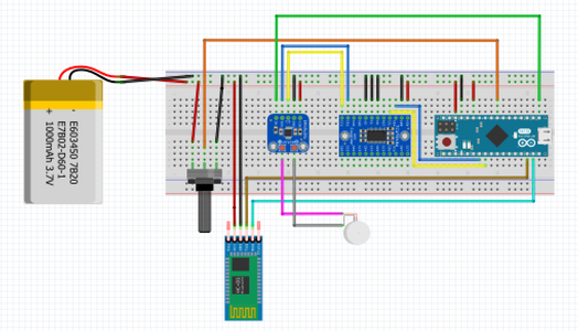

Step 1: Circuit
The full circuit can be found in the Fritzing file appended below. Note: the TacHammer is displayed in the circuit using a Vibration Motor - ROB - 08449, as it has the same input connections. In this project, a circuit without Bluetooth is used, meaning that the Arduino needs to be directly connected to a computer.
However, there is an option to use bluetooth, in which case two more components are needed: a Bluetooth HC-05 Module and a 9-12V battery. The circuit diagram for this circuit is in the same Fritzing file as the other one.
The basic functions of the different components found in the circuit are:
  • Arduino Micro: contains the program that controls all the inputs and outputs for the control of the haptic actuator.
  • Motor Controller: it receives commands from the Arduino Micro in order to send the right signals to the TacHammer actuator.
  • Multiplexer: allows the Arduino Micro to send signals to more than one motor controller in order to have multiple TacHammers actuators running in parallel.
  • Potentiometer: for this application, it is used to change the amplitude of the signal sent to the TacHammers.
  • HC-05 Module: it allows for bluetooth communication between the Laptop and the Arduino Micro.
