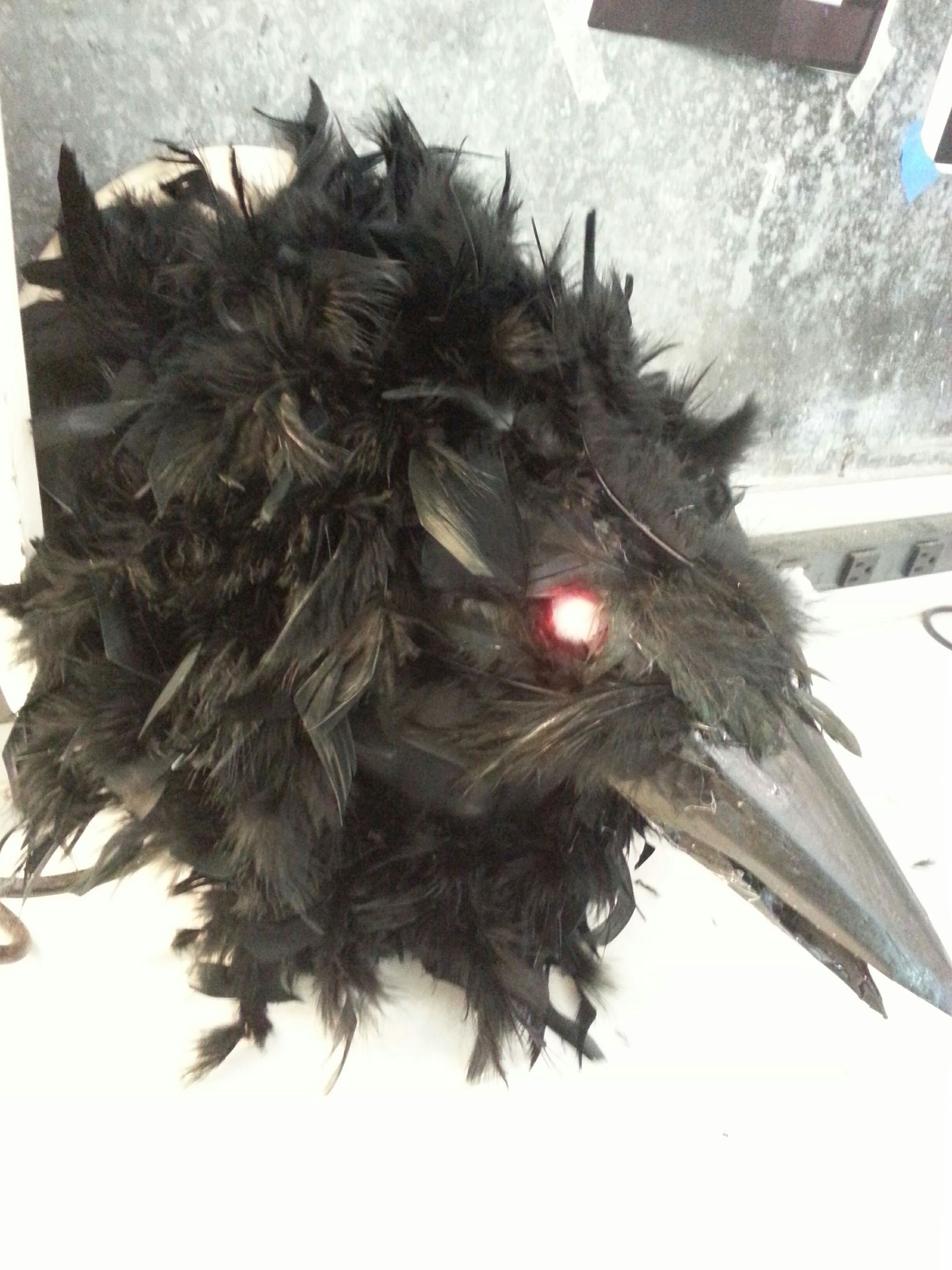

Step 4: Paint/Feather/Mount Head
so before attaching the head to the mount I painted it and feathered because I didn't want to run the risk of getting something important painted or glued. I used Hot glue to attach just about everything.
after mounting the head onto the wood attached to the pan and tilt I connected the jaw to the servo. The jaw I glued the fishing wire in the position of open mouth tightly so when the servo pulls back slightly it takes the mouth with it to a closed position even though only slightly.
Step 5: Eyes
So originally I was going to make the eyes able to move but I made my head to small and it hindered that. so instead of re doing my whole head I just took small foam balls you can find in the garden section of most crafts stores and sliced them in half and put in LED's instead.

Step 7: Finishing
so to finish I covered the servos and wiring with a black cloth and then took a feather boa from a craft store and cut it in sections then glued a couple sections to the cloth to make the neck.
Ta-Da! now its done. unless you want to ad your own touch.
