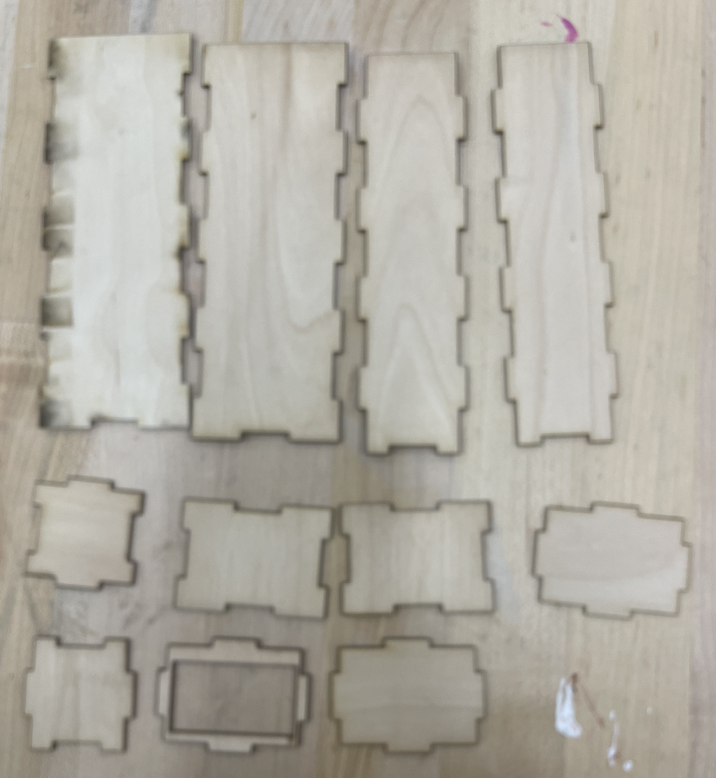

Step 1: Laser Cut and Assemble Boxes
To start this project, you'll need to laser cut three wooden boxes that will serve as the base and top for the robot. The base will sit securely on top of the red metal frame, while the top will sit on top of the base, creating a raised platform to provide ample space for the claw mechanism to grab onto a plastic bag.
Bottom/Base Box:
  1. Download the Design File:
  2. Get the file named bottom_box.ai attached below to access the box's outline.
  3. Understand the Design:
  4. The piece with the carved-out center (least amount of wood) is designed to hold the breadboard and Pico W.
  5. Smaller cuts around this piece are intended for wire connections, which will be added later.
Top Box:
  2. Get both the files named top_box.ai and top_box(1).ai attached below to access the box's outline.
  4. The two prints should be aligned vertically with the prints from the top_box.ai going on the bottom and the prints from the top_box(1).ai going on the top.
  5. The box should be put together with the opened part of the box facing up.
Once the pieces are laser cut, assemble the box with wood glue, and double-check the fit with the red metal base before moving to the next step. On a side note, when putting together the two pieces for the top part, although wood glue could be used, because they don't stick very fast and strong, using a hot glue gun is another option.

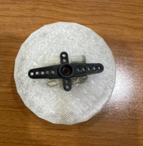

Servo Part Assembly
  1. Attach the Servo Arm Fitting:
  2. Locate the part with four small protruding rectangles designed to fit the servo arm.
  3. Superglue the servo arm to this fitting for enhanced stability.
  4. Connect Transparent Pieces:
  5. Take the two transparent 3D-printed parts and fit them together.
  6. Since the design ensures a snug fit, no glue or tape is necessary. Push the parts firmly to eliminate any gaps.
