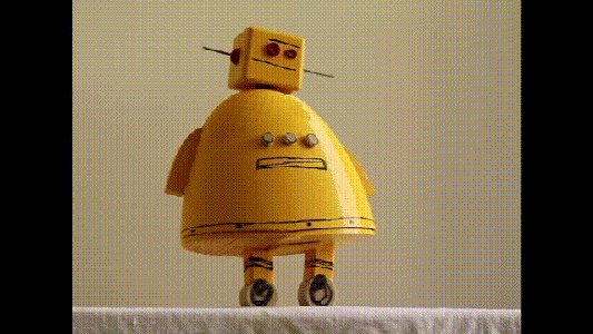

I've always found the Instructables mascot funny. Unfortunately, it only appears as a logo on the web pages, not as a figure, sticker or other merchandise, not in 3D. That's why today we're building our dancing Instructables robot, an automated jumping jack.

Step 2: Assembly of Parts
  1. Glue the legs onto the feet
  2. Fix the large body part onto the legs – don't forget to coat the small plate with glue.
  3. Insert the ball bearing together with the screw into the hole provided - secure with adhesive.
  4. Prepare the head: carefully attach the ears and eyes with a little glue and press on.
  5. Place the head on the pendulum and glue it in position.
  6. The head pendulum can be attached to the screw of the ball bearing and screwed in position.
  7. Pieces of wire or toothpicks are inserted into the holes for the arm hinges and fixed with hot glue on one side only (the ‘back’).
  1. A little tricky: the arms are attached to the pendulum with a strong thread so that when the pendulum moves, the arms move with it.

Now it's just a matter of embellishing: lines, eyebrows and screws are drawn on with a foil pen, exactly as shown in the logo template.
