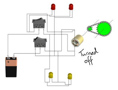

There are many ways you can do this! I made it so that the car could travel forwards and backwards, with the front lights on as it goes forwards and the back lights on as it reverses. This meant having a switch with on (forwards) - off - on (reverse); thus having the continuous rotation servo hooked twice, but each with opposite polarities, so it spins different ways. This is easy to solder but complicated to explain, however, you could simply have a switch which when turns on move the car.
Be sure to check which way the car will go before soldering everything together.
