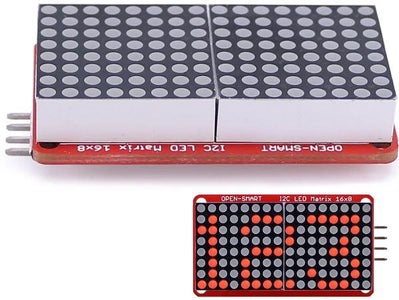

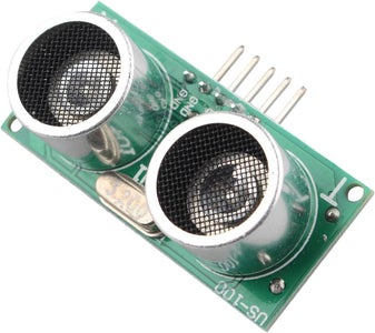

One nice thing about the kit is that it exposes certain pins for further expansion possibilities. I decided that what the hexapod needed was a head with a dot matrix mouth and ultrasonic sensor 'eyes' that could scan from side to side and provide the necessary information to code in some object avoidance. I also added a buzzer for good measure!

OPEN-SMART 0.8" Inch 16x8 I2C LED Dot Matrix Display Module 4 Pin Red LED Matrix for Arduino https://www.aliexpress.com/item/1005004399231415.html
US-100 ultrasonic sensor https://thepihut.com/products/us-100-ultrasonic-distance-sensor-3v-or-5v-logic
Note this project uses the US-100 Ultrasonic Distance Sensor not the HC-SR04 which has slightly different dimensions (and didn't play nicely with the existing code).

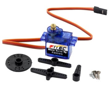

mg90s servo https://kitronik.co.uk/products/2592-mini-180-degree-metal-gear-servo-mg90s

The dimensions do vary a bit with mg90s servos but I think my support will handle most varients.

Mount the led matrix in the lower part of the head with pins sticking out to the right as you face the head. It should be a tight push fit. I bent the pins to about 45° but you may prefer not to.
Mount the ultrasonic sensor and secure with a couple of tiny self tapping screws.
Attach the servo horn to the head piece. Don't connect the head piece to the servo just yet.
