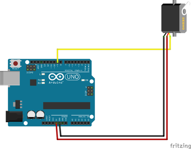

Step 1: Wire the Components All Together
In order to make the whole setup work, you just need to wire all the components in the way I show you in this picture.
If you need further explanation on how each element works or why I use them that way, you just need to visit the article on my website and get some instruction on it (it's in Spanish but, if you are not fluent in that language, Google translator will do the job 😉).
