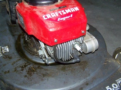

Your mower does not start. Sometimes it fires weakly, but yanks the starter cord from your hand.
Your flywheel key is sheared and it needs to be replaced. The flywheel moved and sheared the key. Now the engine timing is very much incorrect. The spark comes at a time that makes the engine want to run backwards, but it cannot.

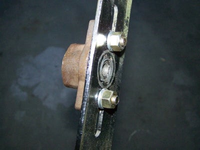

Pictured is a repair I made to the blade holder. It had two raised tips to fit the blade slot. Those had become battered and the blade had some looseness, no matter how tight the center bolt was. I drilled out the tips and replaced them with hardened bolts. (Because of space limitations, I had to grind one side of each bolthead away at the top of the blade holder. This blade is actually a thatching blade. Somehow it is causing flywheel keys to shear. I think I will no longer use a thatching blade on this mower.)

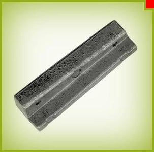

Although sold by Sears, my mower engine is made by Tecumseh. There are several flywheel keys used on Tecumseh engines. Even if your mower is sold by Sears, you can take the Sears model number to your local mower shop and they can find the correct key for you. The key shown is part number 611004. It has a wider, thicker portion at one end. That end faces down on my engine. I was assured the key and flywheel would fit only when the key is in the correct position. (The photo is from Google Images.) A new key is about one dollar (US) in cost.

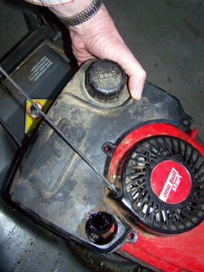

The first step is to remove the gasoline tank. You will need to remove the oil dipstick first and set it aside someplace clean where it will not attract dirt. Set the tank aside, even though connected by its rubber hose. Set it with the cap upward so gasoline will not leak out. Also remove the red cooling shroud.

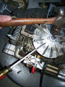

Step 4: Prepare to Loosen the Flywheel
Most people will not have a factory issue flywheel puller in their toolbox. You do not need one, if you are careful. Remove the starter rope cup and put the nut back onto the threaded portion of the crankshaft. Turn it until the face of the nut is exactly flush with the top of the crankshaft.
Step 5: Pry and Tap Sharply
Use a long screwdriver to pry from below the flywheel. Do not pry too hard. You do not want to crack the crankcase. At the same time, tap sharply on the nut. The nut protects the threads. Turn the flywheel a quarter turn after 3 or 4 taps. It will come loose more easily than you would expect. When it breaks loose, remove the nut and lift the flywheel off.

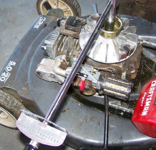

Place the flywheel on the crankshaft. It should slide down smoothly over the new key. Oil the threads on the end of the crankshaft. Place the cup, the washer, and the nut onto the crankshaft. Begin to tighten. Never pry against the flywheel cooling fins. They break easily. Turn the flywheel a couple of times to make certain it turns smoothly and nothing is obstructing it. If you did not tie back the dead man's clutch, you will hear a terrible scraping sound. Torque the flywheel nut. The recommended specifications are usually around 33 foot pounds. On some engines the figure will be 35 or 39 foot pounds. In general, if you are shearing a lot of flywheel keys for no reason, the nut is not yet tight enough.

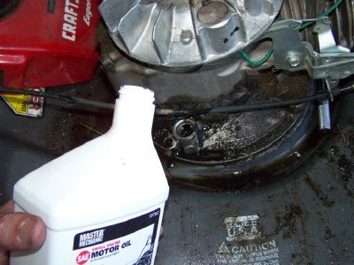

Step 9: Top Off the Oil
When turning the engine while the oil fill is open you are certain to have some oil belch out of the engine. Top off the engine with new oil. Usually you fill to the level of the opening.
