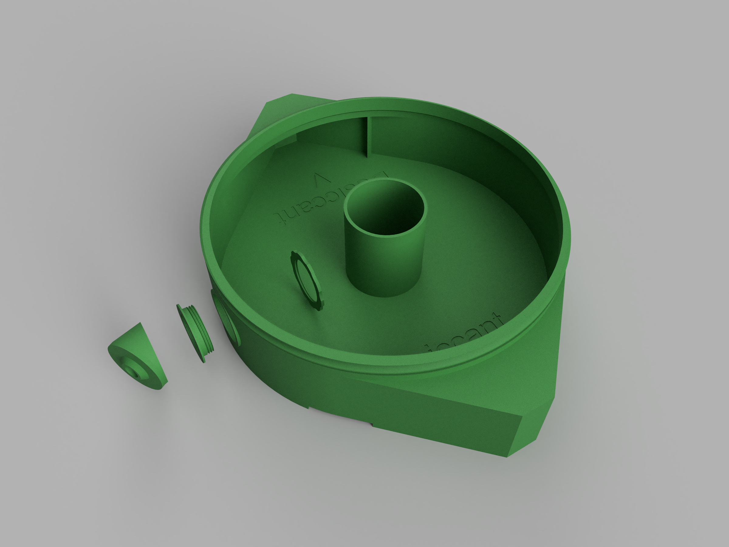

Step 1: 3D Printing (Build)
Mr. Speaker is created as 6 pieces (STL files below).
The over-all model was designed in Autodesk Fusion360 and that file is also provided so that users can modify the design if they wish. I'm sorry to say I have not included the design history because it became way too messy.
- Body
- Top
- Port Tube
- Tweeter Cups
- Bottom
- Battery Cover
I designed the entire speaker knowing it would be 3D printed so avoided direct overhangs where possible by using chamfered edges. The 'phase plug' (we'll get to that later) also helps act as a support for the tweeter hole. This all means supports do not need to be added during slicing.
The two exceptions are the Bottom component that has large overhangs on the battery compartment and the Battery Cover itself. It would be wise to generate supports for both parts. That said I did print the Bottom without support and bridging of the gap was successful.
The Battery Cover prints okay without support laying flat, but I found the layer adhistion was not strong enough on the clip that needs to bend. So I printed it standing up with supports, to align the layers in the strongest way for the clip.
I slice models in Cura. To keep the Z-seam neat, enable 'Z-Seam Alignment' and 'Z-Seam Position' settings. Set alignment to 'Back Left' and then rotate the part until the Z-Seam is kept maintained along one edge. This is particularly clear to see on the main body. You can visualise the Z-Seam better in Cura if you enable the 'Coasting' setting.
I also recommend enabling 'Z-hop' so that the print head does not hit delicate tall parts such as the tweeter phase plug or the port tube while it is being built up. I do enable 'combing' but with the setting 'Not in Skin'.
I strongly recommend printing all other parts before the main body. The main body is a long print so you want to be confident everything is dialled in for your printer and filament. I used maximum part cooling to aid overhangs but this can result in some stringing especially on small details like the tweeter.
After the main body was printed I used some 220grit sand paper to remove rough endges from the back of the phase plate area so it would not contact the tweeter cone. The phase plate should be approx. 0.5mm from the tweeter cone, so it needs to be smooth and clean.

The Top piece and the Port tube slot together and it's a good idea to use a little sealant again here.
The port tube should be oriented towards the small cut-off corner of the top piece, that's the back of Mr. Speaker. The larger cut-off corner is the front.
Finally, the top piece can be snapped in to place. Again a bit of sealant should go on the joint once you know everything is operating correctly.
