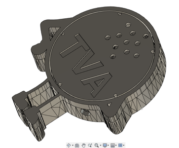

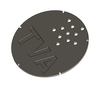

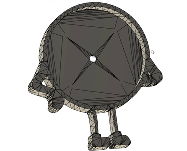

Step 1: Building Miss Minutes Enclosure

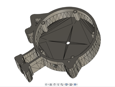

Usually, I start with electronics and work my way up to building the enclosure but in this instructable, I'm going to approach this project a little differently. First I’m going to make the enclosure and then later fix the electronics within it.
Before I started modeling I tried searching if someone has done a similar project already and I found this amazing Miss Minutes clock project by a Thingiverse user PhilippHee. But unfortunately at the time of documenting the project page is down on Thingiverse, I will make sure to update the link once the page is back up.
Anyway, I had downloaded the STL file a few weeks back. So, instead of me creating the project completely from scratch. I edited and remixed his project for my need by using fusion 360. You can see the images above to see how the image was modified to meet the need for this project.

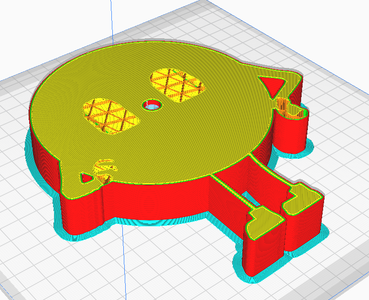

Step 2: Multi-color 3D Printing

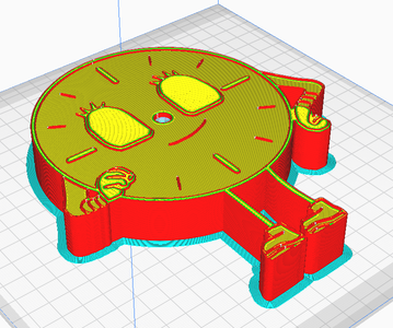

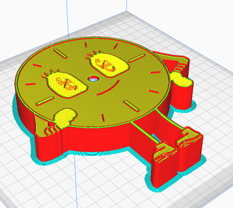

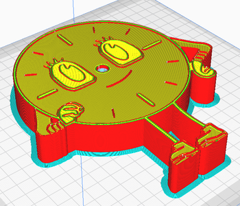

Once the STL file was ready, it was time to print. I took the model into Cura and sliced it. You can either use a single color to print and then paint the eyes and the outlines on top of it. Or change filaments while printing as I did.
You can check this link to see how to change the color while printing just using one nozzle.
The above images are reference images where you need to pause to change the color of the filament.
- Initial - Orange filament
- First change - Black Filament
- Second change - White Filament
- Third change - Black Filament
To print this model I used PLA and a larger nozzle with a diameter of 0.6mm and a layer height of 0.4mm for faster printing. It approximately took 9 hours for the complete print for this model, during the print I had to change the filament 3 times. But still, I managed to mess it up by not selecting the proper layer height to change the color.
Anyway, this gave an opportunity to explain, how you could change the colour if you had not used the multi-color 3d printing technique.

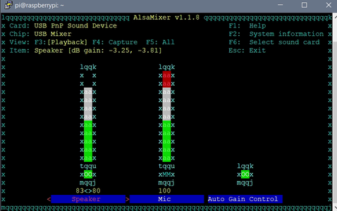

Finally, adjust the volume using the command
alsamixer
This sets up the audio input and output for raspberry pi zero w

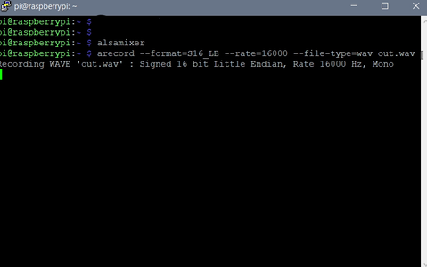

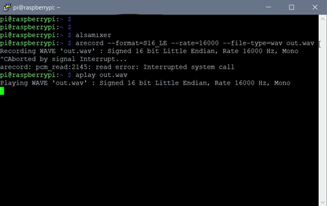

Step 7: Testing Audio and Microphone
Test speaker
speaker-test -t wav
You can use this command to record the audio
arecord --format=S16_LE --duration=5 --rate=16000 --file-type=raw out.raw
and this command to play the audio you recorded.
aplay --format=S16_LE --rate=16000 out.raw

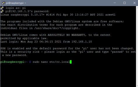

Step 11: Run Google Assistant on Startup
Run the command
sudo nano /etc/rc.local
Enter the following command with your file destination and followed by '&' before exit 0
sudo -H -u pi python3 /[path to pushtotalk]/pushtotalk.py &
To make sure you have an internet connection before running the assistant
type this command
sudo raspi-config
then select boot option and then enable wait for the Network at boot
This will start the google assistant during boot with a stable internet connection.
