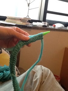

Step 2: Cast On
Cast on 48 stitches.(To fit kids' size)
Gauge:
approx. 3stitches = 1inch. 3.5rows = 1inch in stockinette stitch on 8mm needles
Gauge:

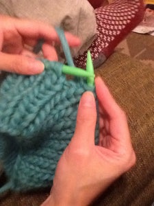

Step 3: Ribbing
row1 to 15
Begin with 1by1 ribbing using blue color.

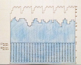

Step 5: Snowscape
row28 to 37
Knit hat as given in pattern using white and blue yarn. (follow the knit chart)
