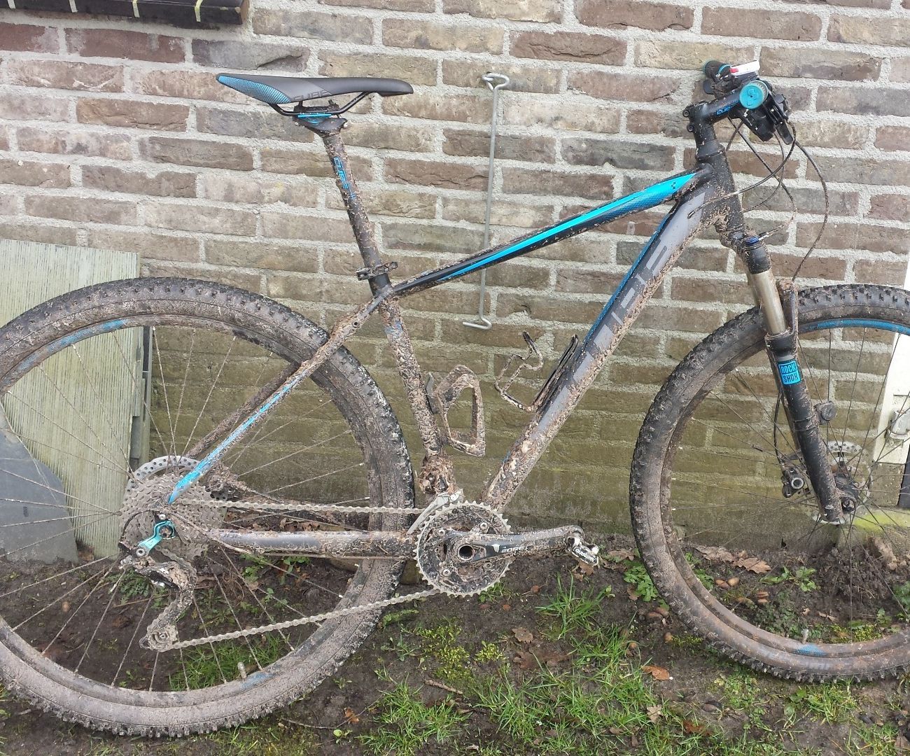

Introduction: Cheap Mtb Led Front Light
I used 1 5w12v led in this build, you can also use more powerfull led spots or use more than 1
With this setup the battery will last around 5 hours
The price of the parts was around 20 euros You can find almost all the parts on ebay or your local lumberyard
The led is 500 lumen
You can charge the battery with the 2 nails on the cap and a 12v battery charger
