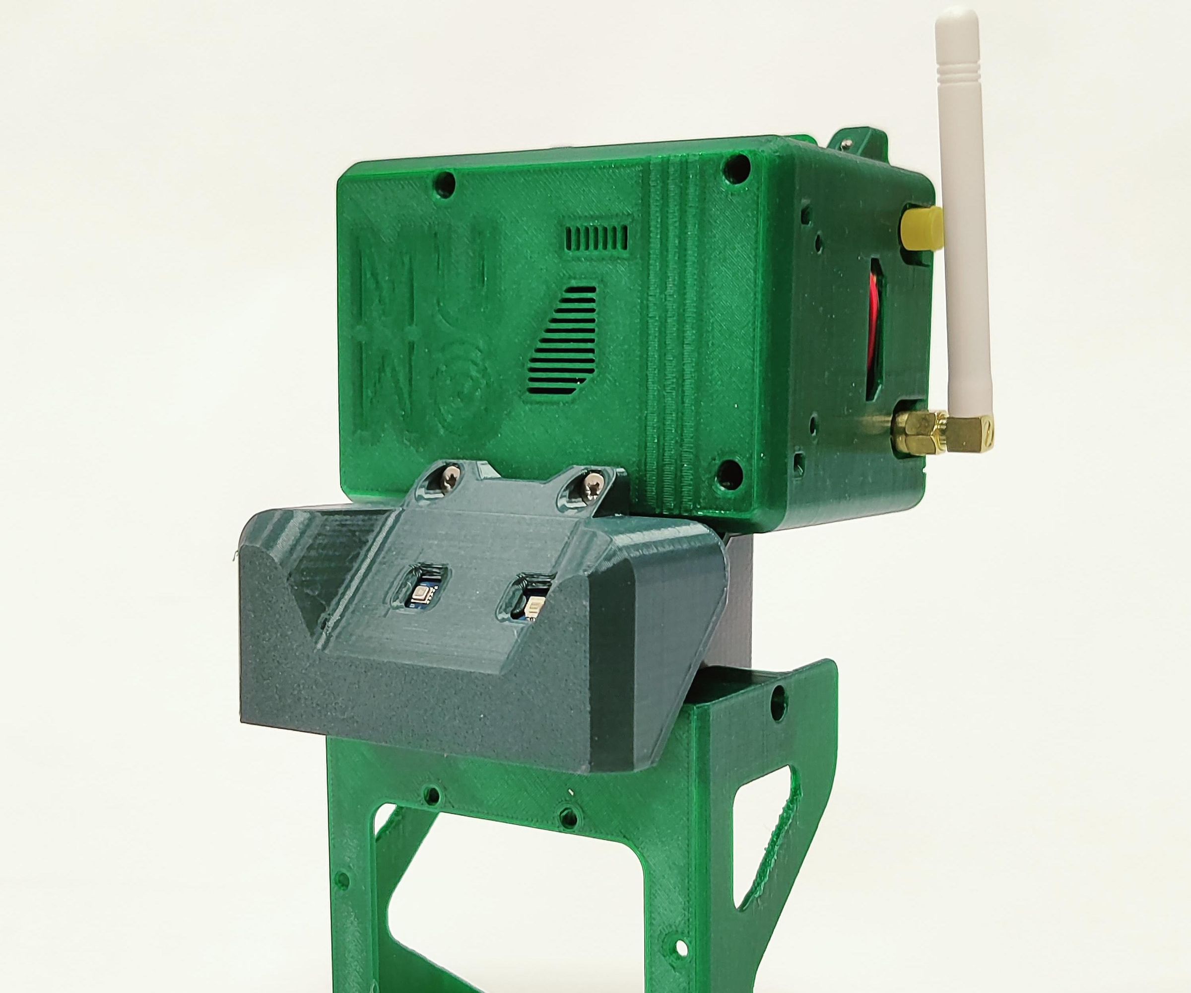

MuMo Node
The MuMo Node is a low power device on AA batteries that can measure and transmit environmental parameters over a LoRa network. The parameters are temperature, humidity, ambient pressure and brightness.
*** The MuMo node can be extended with other functionalities to be used in other applications.***

Step 5: #Hardware - Assembly 1: TSL2561 / BME680
Parts:
- 3D print - "Node main body"
- Digital light sensor (small sensor)
- BME680 sensor (long sensor)
- 2 x Grove I2C connector cables
- 4 x M2x5 screws
Instructions:
Connect one of the grove cables to the digital light sensor. And the other to the BME680 sensor.
- Place the sensors into the 3D print housing ("Node main body").
- Digital light at the top left / BME680 at the top right. The connection part of the sensor is face down (not visible!). You have to bend the cables that they make a sharp turn.
- And screw both into place with the m2x5 mm screws.
Step 6: #Hardware - Assembly 2: Seeed LoRaWan Board
Parts:
- Battery tray with battery holders
- Seeed LoRaWan board
- Main body node
- 4 x M2x5 screws
Instructions:
- Insert the power cable of the battery tray into the LoRaWan board.
- Bend the power cable over so the cables so they don't take up to much space.
- Insert the LoRaWan board into the housing with the usb connector and power cable first.
- Align the holes of the LoRaWan board with the mounting pins of the housing.
- Make sure to place the LoRaWan board next to the dividing wall. (see pictures)
- Insert the four screws into the indicated position of the board (see top view picture - Green circles)
- When you tighten the screws make sure the reset button is properly aligned with the push button on the side of the node. (see top view picture - Blue rectangle)
Check if the reset button is properly working. If the button does not move or doesn't touch the reset button or the board there might be inconsistencies in the 3D print quality. Try moving the board slightly or consider breaking off the plastic printed reset button entirely to solve this. You can still reset the button trough the hole in the print.
Feed the antenna trough the foreseen opening in the battery support block, carefully thus not to break the antenna

Step 24: #Hardware - Attachment of the Device
There are several ways to attach the device.
- Screw slide lock groove on the side.
Screw slide lock groove on the back.
Tiewrap groves on the side / top and back.
The backcover of the node is also provided with a hook.
