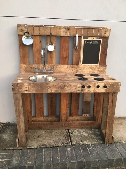

Step 1: Make the Frame
Turn one of the wooden pallets upside down, and saw through the two outer wooden slats, as illustrated.
Step 2:
Using the hammer and crowbar, remove the blocks and slats as illustrated.
This pallet will form the main structure of your mud kitchen.
Step 3:
Stand the pallet on its edge. An adult should hold this in place to prevent it falling over.
Step 4:
Using the blocks that were removed in Step 2, place these 420mm from the lowest edge of the pallet, drill, countersink, and screw into position as shown.
Step 5:
Drill, countersink, and screw, one of the 1200mm long pieces of wood to the top face of the two blocks.
Step 6:
Lay down the second pallet, and saw through both sides using the top slat as a guide.
Step 7:
Trim the length of this section with the saw until you have a piece identical to the one illustrated. Follow the wooden blocks as a guide to trim the excess either end.
Another of these pieces should be made from the other end of the second pallet.
Step 8:
Stand these two new sections in front of the main structure of your mud kitchen.
Step 9:
Place the second of the 1200mm long pieces of wood across the top of these uprights; drill, countersink, and screw into position.
Step 10:
Remove some slats from the 3rd pallet, and cut four 460mm lengths.
These should be drilled, countersunk, and screwed to the sides of the mud kitchen as shown.
Step 11:
Place the third 1200mm long piece of wood below the 'splash back' of your mud kitchen. Drill, countersink, and screw into position.
Step 12: Make the Worksurface
Remove more wooden slats from the third / fourth pallet and cut twelve 305mm lengths for the work surface of your mud kitchen. The edges and corners should be sanded with sand paper before fitting.
Drill, countersink, and screw the work surface slats into position.
Step 13: Fit the Sink
To fit the sink. Measure the diameter of your stainless steel bowl, and draw an appropriately sized circle onto the work surface of your mud kitchen. The rim of the bowl should not fit through the hole.
Using a jigsaw cut out the hole, following the pencil mark on the work surface.
Step 14:
Drop the bowl into position in the work surface.
Step 15: Fit a Utensil Rack
Screw the utensil rack into position on the top of the splash back of your mud kitchen.
Step 16:
Stand back and admire your beautiful mud kitchen.

Reply 8 years ago on Introduction
Thank you. Yes, here's the finished article.
