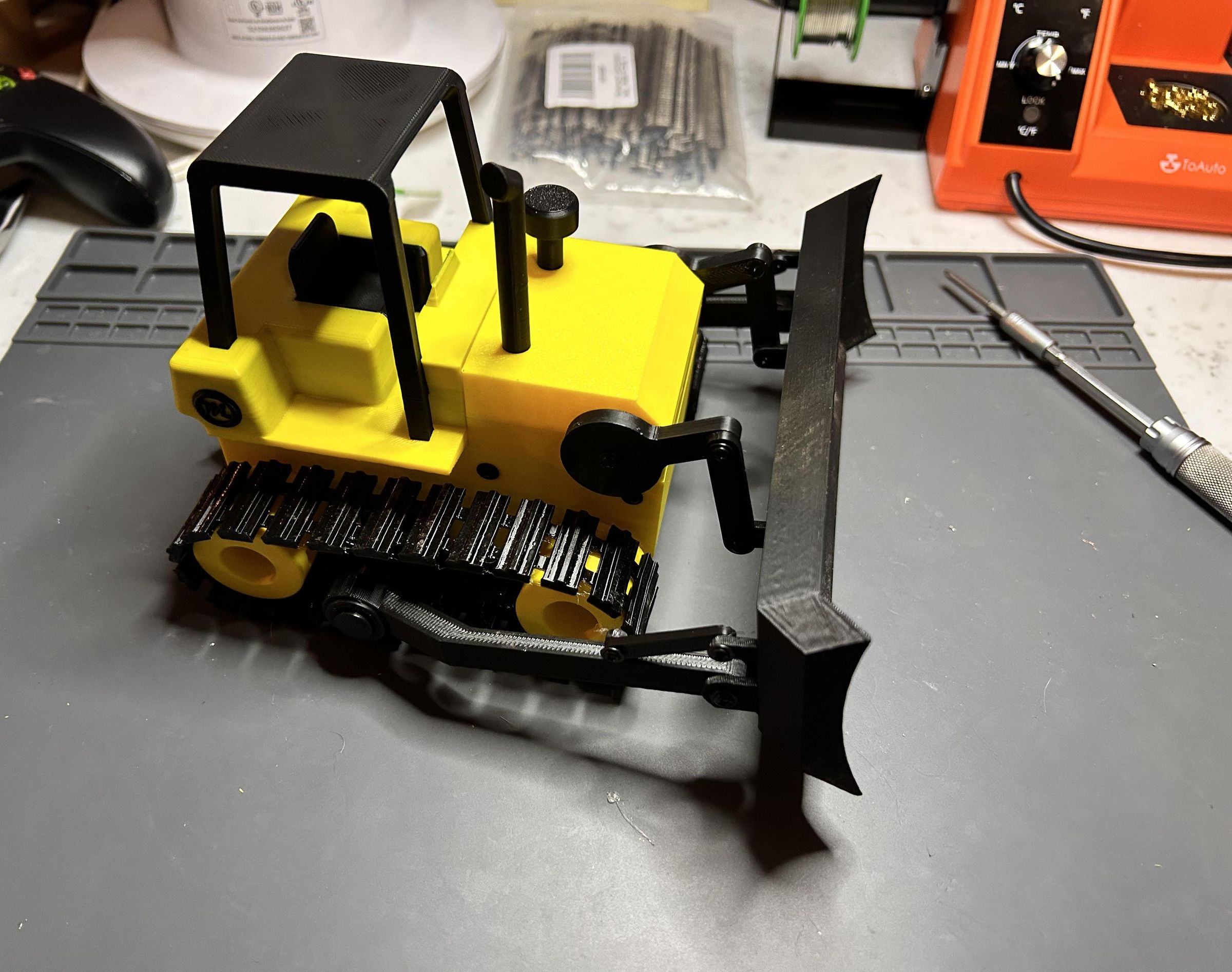

Introduction: Muddy Mini Tractor
This is a mini 3d printed rc tractor
You need a #1 Phillips, a small flat head, 2 16340 batteries, and a controller off this list https://github.com/ricardoquesada/bluepad32/blob/main/docs/supported_gamepads.md I will be using an Xbox One controller and that’s what the code is for but I believe any gamepad on the list will work.
