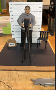

This project is an interactive sculpture that reacts to real-time DUI arrest data from the City of Chicago. A servo rotates a figurine on a turntable while LED strips flash like a camera, creating a “mugshot” effect. The goal was to turn raw data into a playful, thought-provoking experience by combining art and code.

Step 2: Building the Sculpture
Build a paper mache figure and paint it to look like a detainee. Attach the figurine to the servo horn so it rotates smoothly without tipping. Build a mugshot-style backdrop with height marks and arrange the LEDs like camera flashes. Feel free to add any items to make the scene more realistic.

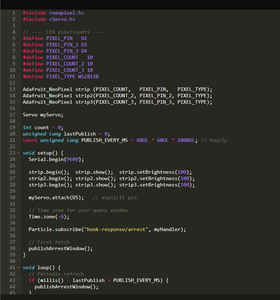

Step 3: Webhook
I created a Particle webhook that connects to the City of Chicago’s arrest database. The URL checks for arrests between two dates I send from the device and filters for the charge “Driving Under Influence of Alcohol.” The webhook returns just the count, which drives the servo and LEDs.
Step 4: Coding

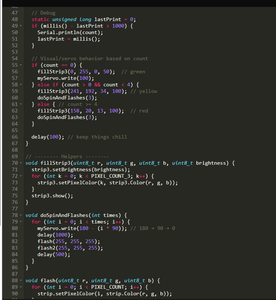

Write code that publishes the min/max dates to the webhook, receives the arrest count, and maps it to servo + LED actions:
  1. 0 arrests = green LEDs + slow spin
  2. 1–3 arrests = yellow LEDs + 3 spins/flashes
  3. 4+ arrests = red LEDs + 3 spins/flashes
