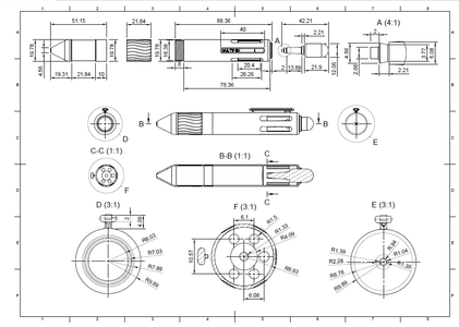

The Barrel is 88.36 mm long with a diameter of 19.78 mm, while the cap is 51.15 mm long with diameter of 19.78 mm, and 4.56 mm at the nose cone. While it’s possible to just purchase a multi pen with the same measurements, it’s advisable to use 3D printer instead, because the holes in which the Thrust Devices should be put are relatively bigger than the normal ones. The holes must be 6.1 mm away from each other, and 20.4 mm long. The hook, however, is 40 mm long, and is 5.28 mm away from the two holes.

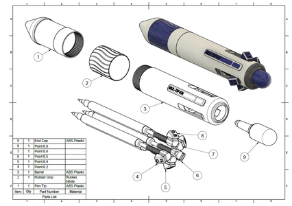

Ink Chambers and Ballpoint Tips are available in some bookstores, and they could be purchased separately. However, if it happens that they aren’t available, you could just purchase five different pens with different tips (could be of your own desire), cut them in desirable measurement of 72.92 mm. It must be noted though that the Ink Chambers must all have the diameter of 6 mm.
Step 3: Springs and Thrust Devices

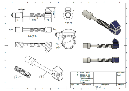

The springs are available in bookstores, just make sure to buy the Springs that are of the same length and diameter as what shown in the design, which are 16 mm and 3 mm respectively. While Trust Devices are also available for purchase, it is advised to do    it using 3D printer for a better fit. See the image below for the measurement:
Step 4: Assemble
In this section, you just need to put the materials all together. Put the springs around the body of each thrust device, and then shove it in the ink chambers. Assign each Thrust Device to the holes in the Barrel, then put the Cap on and secure it shut. And just like that, you now have a pen with multiple Ballpoint Tips.
