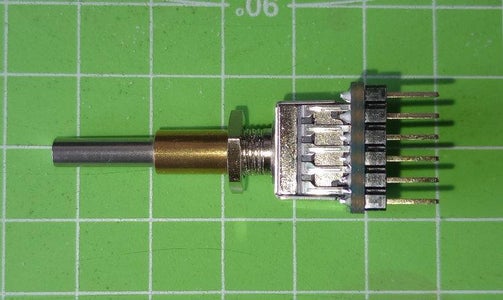

  • 2 Stacked double rotary encoders, like ELMA E37 (to adjust values)

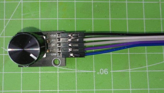

The single rotary encoders are quite common. Have a look to find a variant soldered to a PCB ready for use with an Arduino and a knob. They can be easily connected to the Arduion with a jumper cable.

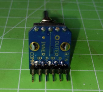

The stacked rotary encoders are industrial grade and a litte expensive. Some dealers provide a PCB for connection with an Arduino, but you have to solder the encoder and a row of PIN headers to the PCB on your own. If you think these are to expensive you can of course replace one double encoder by two cheaper single rotary encoders.

The pins for the single rotary encoder are connected as (PIN on rotary - wire color - pin on Arduino):
  • GND - blue wire - GND
  • + - not needed to connect
  • SW - grey wire (button) - 32
  • DT - white - 34
  • CLK - black - 36
The pins for the two double rotary encoders are connected as (PIN on rotary - wire color - pin on Arduino):
  • COMM - blue - GND
  • Inner B - green - 22/23
  • Inner A - yellow - 24/25
  • Outer B - orange - 26/27
  • Outer A - red - 28/29
  • Button - brown - 30/31

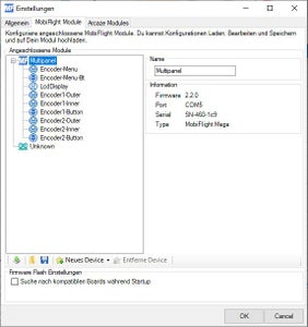

Download the MobiFlight software MobiFlight-Installer.exe. Move the software to a separate folder. This is important because the installer will download the real software to the same folder as the Installer.
Connect the device to your PC. Afterwards start the just downloaded MFConnector.exe. When starting the software will scan for compatible Arduino devices. When asked if you want to install the special software accept it. This will change the default Arudino firmware by the special MobiFlight firmware. This step can be reversed with the connector software.
Step 7: Configuring the Attached Input and Outupt
The first part is to enter which hardware is attached to the Arduino. In our case this are more than you might expect.
First of all the rotary encoders do have a pushbutton as well. Next the double rotaries are set up as two individual devices. I named the single rotary as Encoder-Menu and its button as Encoder-Menu-Bt. An encoder is using two pins to determine if the knob was turned left or right. According to the wiring diagram some steps above i used the pins 36 for left and 34 for right. If you encounter that this does not fit for your encoder just swap the pins. Same applies to the type. For my encoders the type 1 detent per cycle (00) was correct.
Next i added the Display as LcdDisplay. The I²C devices all have an assigned address. Refer to the documentation of your display which address is preselected. In many cases this is the address 0x27. The number of columns is 20, the number of rows 4.
The outer and inner rings of the upper double rotary were added as two encoders and the included button as well. Same for the lower double rotary encoder and its button. For the ELMA E37 the left pin always have the higher pin number than the right pin. Refer to the wiring diagram for details.

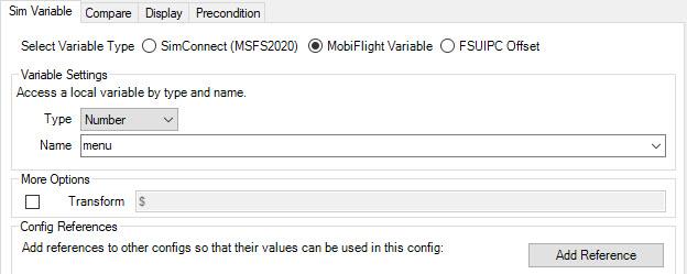

As the first task we will activate the single encoder to work as a menu selector. This way we will be able to have configurable number of menus (or tell them screens) to use the double encoders for different tasks.
We will start on the Ouput tab of the MFConnector main window. Add a new line by double clicking the name and assigning a name. I chose menu as the name. This step has created a globally accessible variable with the name menu which we will use quite often.

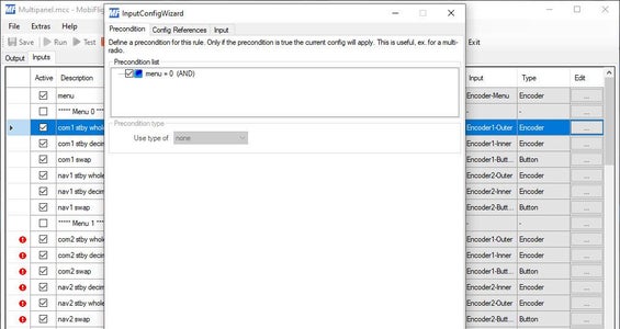

Next we want to be able to change this variable using the single encoder. Change to the Input tab of the main window and add a new item. After giving a name like menu or menu input open the configuration of this new item. Choose the correct Arduino (here Multipanel (COM5)) and the device Encoder-Menu.
Now we want to tell MobiFlight what to do when the encoder is used. We will begin with the On Right event because this is a little bit easyer to understand.
Choose the Action Type value MobiFlight - Variable. In the next line you have to select the variable menu which was created on the input tab. In the line Value we tell what to do. The formula is ($+1)%7. The $ will contain the value of the variable menu. We add 1 to this value. Next we do a modulo operation. This will give the remainder of a whole number division. Samples:
  • Value was 0 -> (0 + 1) is 1, dividing 1 by 7 is zero with a remainder of 1. 1 is assigned to menu.
  • Value was 6 -> (6 + 1) is 7, dividing 7 by 7 is one with a remainder of 0. 0 is assigned to menu.
With this code when turning the encoder to the right it will change: 0 - 1 - 2 - 3 - 4 - 5 - 6 - 0 - 1 and so on.
The left direction is a little bit more complicated. The formula is ($-1+7)%7. When starting from 0 the new value will be -1. We add 7 to -1 which results in 6. 6 divided by 7 is 0 with a remainder (% operator) of 6. When turning the encoder to the left this code will change the variable menu: 0 - 6 - 5 - 4 - 3 - 2 - 1 - 0 - 6 and so on.
If you want to have more or less menu pages, just change the digit 7 in both formulas (left and right) by the new number of menu pages. Sample: changing to ($+1)%3 and ($-1+3)%3 would result in a menu changing 0 - 1 - 2 or 0 - 2 - 1.
Change back to the Output tab of the main window. When turning the knob to the left or to the right you should see the value in the table accordingly.

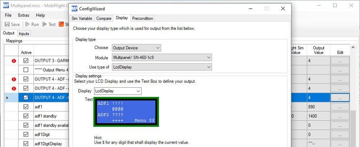

Now we want to display this menu value to the attached display. Add a new line by double clicking and assigning a name like display. Open the settings for this new line. Select the menu variable in the Sim Variable settings. Change to the Display tab and enter data like in the screenshot above. Again the $ sign is a placeholder for the value of the variable menu.
When anything worked like expected you'll see the screenshot above on the display. When using the menu encoder the appropriate value should be shown.

The screenshots are showing samples for Output and Input. In both cases you see, that only some are used to be displayed or used to change values. By using the Precondition we are able to control what happens in which menu. The standard case is that you have quite a lot of red exclamation marks that indicate that the Output/Input is inactive for the moment. When changing the menu with the topmost rotary, the exlamation marks should move.

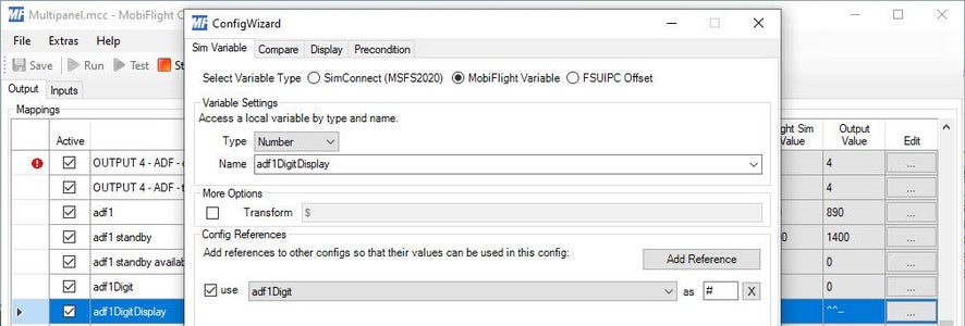

First we add a new MobiFlight Variable on the Output tab as shown in the first image. Its named adf1Digit. This provides a new variable which we will control on the Inputs tab.
Change to the Input tab and map one of the rotaries to this variable as shown in the second image. The change of this variable is done the same way as for the menu variable. In the case of the ADF we need three values (0, 1, 2) which will be resposible for the 100, 10 and 1 increment/decrement of the frequency. The code for On Left will be ($-1+3)%3 and the code for On Right will be ($+1)%3. When done you will see the new variable changing on the Output tab changing 0 - 1 - 2 - 0 or 0 - 2 -1 - 0.
Now we want to give a hint on the display, which digit we are setting when using the other rotary switch. We introduce one more internal variable I called adf1DigitDisplay. Important is to add a Config Reference to the above mentioined variable adf1Digit. Remeber the sign this variable is assinged to, in the screenshot it is the # sign. We will need this for the next tab.
We change over to the Compare tab of this new variable and use a special feature of MobiFlight. We will enter a condition which is always true. In this case we know, that the variable will always be greater or equal to 0. By doing so, the line set it to will always be executed.
In this field we enter the formula
if(#=0,'^^--',if(#=1,'--^-','---^'))
This tests if the referenced variable adf1Digit is 0, and change the value of adf1DigitDisplay to the string ^^--. If the value is not 0, it will test the same variable for "1" and change the output to the string --^-, if not it changes the output to ---^. With that done we have a marker on this screen which will point to the digits that will be changed when using the rotary encododer.
Within the display for this menu we reference the variable adf1DigitDisplay (in the screenshot as @) and put this below the display of the ADF1 frequency. This will result in a display like in the last screenshot.
