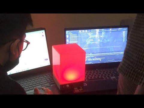

Introduction: Mulitiple Feature Smart Lamp
A Basic Controllable Smart Lamp
By:
Budicahya Rama Bagaskara (2440113433) & Muhammad Kemal Ardiansyah (2440105513) -- Computer Engineering -- Binus University
Hello everyone,
Did you guys know that colored light could affect mood and there is a therapy using colored lights called chromotherapy, which is pretty cool fun fact! Then the idea of making colorful lamp from scratch is popped in our mind. But to make it more cooler and more modern, we will make it 'smart' where we will use internet to interact with lamp and cloud service to store the lamp data.
In this instruction, we will show you, step by step, on how to build basic smart lamp which are using Adafruit Neopixel as lamp's LED, ESP32-DOIT-DEVKIT as project's microcontroller, and Firebase Firestore to store our lamp data.
The smart lamp in this article will be able to change its light color based on user's choice or enable its 'rainbow' light mode where the lamp able to illuminate many colors in one setup. Those two feature can be controlled directly in IDE (In this article, we use Visual Studio Code with Platform IO extension) or edit in Firestore Data.
This article will guide you on how to setup your Firestore for the first time, link your Firestore to IDE, building the lamp from scratch, and lastly transmit the code from IDE to your lamp.
That is all the brief information that overall conclude this article. Now we can continue to build the smart lamp with the help of instruction below.

Step 5: Evaluation
The downside of this project is that we only use WiFi to connect the ESP32 to the Firestore Database. If you have a bad internet connection, it will take affect the performance of the lamp. You can add a Bluetooth connection. You can also add manual input to change the light color or lamp mode using some push button.
This project also gives a 200 ms delay for the Neopixel, you can change it to 20 ms - 15 ms to get a smoother transition. You can also change the power supply with a power bank or even use a 5V adapter. If somehow your voltage source is less than 3.5V, then you may consider utilizing a level converter between the power source and ESP32 to convert your voltage into 5V and vice versa.
