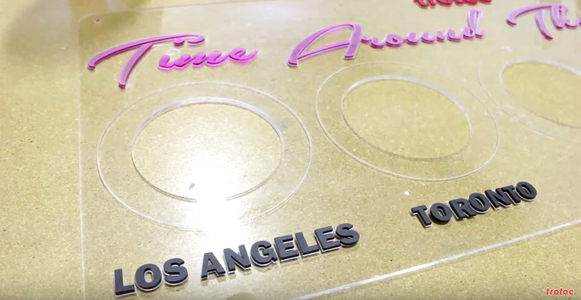

The first step is making the display for the clocks to be mounted on. In order to know where to place the clocks and the acrylic letters, we use the laser machine to make a kiss cut. The kiss cut was made with the SP 500 200W CO2 laser with 20 power and 3 speed.
Once the kiss cut completed, we've used a full cut withthe laser machine to cut the acrylic where the clocks will be placed. This cut was also made with the SP500 200W CO2 laser with 100 power and 1.2 speed.
Step 2: Cutting the Acrylic Letters
To decorate the sign, we used our TroGlass Colour Gloss cast acrylic with adhesive backing. We cut the letters using our SP 500 200W CO2 with 100 power and 1.5 speed.
Step 3: Placing the Acrylic Letters
After cutting the acrylic letters, we removed the 3M adhesive backing and place the letters on top of the kiss cut on the 6mm clear cast acrylic.
