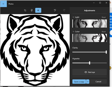

The next part is to open the newly saved picture, turn light and color all the way down and increase clarity all the way. This helps make the black "pop" and makes it easier for the next step. Click to save it and not save a new one.

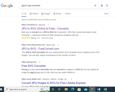

You can google "Jpeg to SVG convertor" to see your options. There are a ton of convertors that are free or free with ads, but I use the top search result which is called convertio.
Add your picture in, convert it and then download the conversion. If the black is really prominent and there aren't shades of grey or other colors, then it should work first try, but you might have to re edit the image.

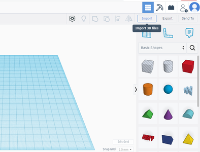

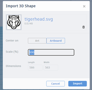

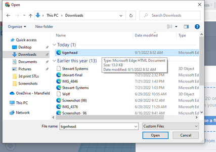

You need to create your new project on tinkercad, then select import.

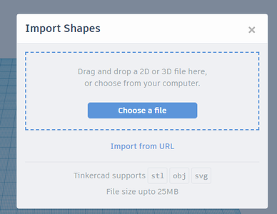

After selecting import, browse for your files and select the newly downloaded SVG file. It should be the most recent item in your downloads folder.
Click to import it, but then look at the scaling. I moved mine down to 40% because the 100% scaling would not fit on my print bed.

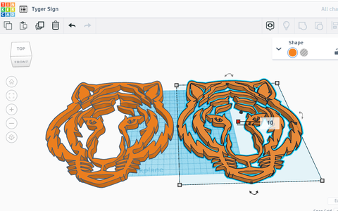

Step 4: Make a Copy for Your Back Ground / First Color
Change your color if you would like and then hit ctrl+c to copy the image, and then crtl+v to paste the copy.
These 2 images are going to be your base color and then your top layer.

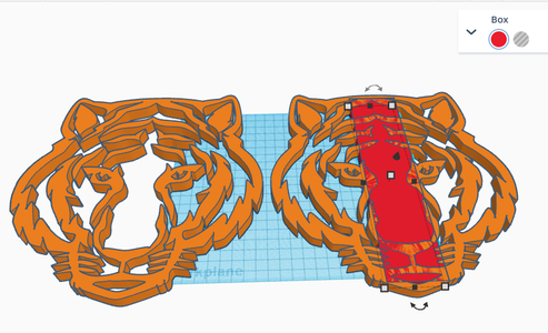

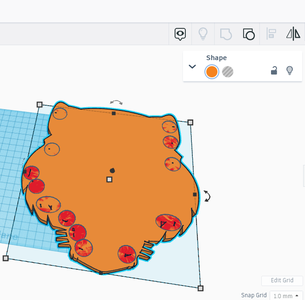

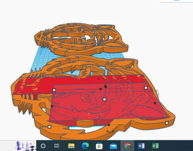

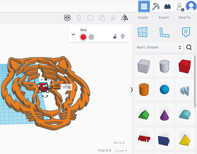

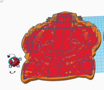

place a square down inside the image and make it a color that's different than what you're working with. Make that square the same height as what you're trying to close off.
Stretch it as far as you can while still remaining inside of the image. You should be able to pan around your image and not see any of the new color showing outside of the walls. Do the ctrl+c and ctrl+v method to continue copying and pasting the shape you just made scaling its length and width to where it can cover open spaces, but not stick out of the original image. Towards the end, I began using circles to fit into hard to reach spaces.

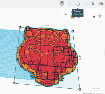

Use your mouse to make a square that encompasses all of the shapes you just made and then select the "group" button to make all of the objects into one single object.

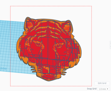

Spot check at the end to look for other holes or gaps and then patch them in and group everything one last time.
At the end you should have the top layer, which is the actual image you want and then the bottom layer, which is the shape of your image and the base layer.

Select both portions of the print by clicking on one and then holding shift and clicking the other and then select the "align" button. Hit the center bubble on the side and top and bottom to assure that they are perfectly flush, then with both still selected, hit the "group" button.

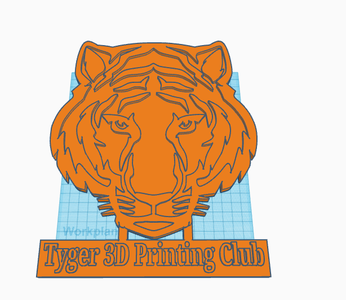

Step 7: Bonus: Adding Words to Sign

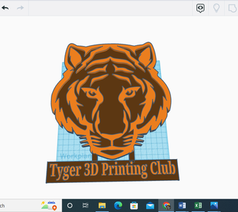

What I do when I add words is that I have the place holder for the words stop at the same layer as the base layer of the file and then I have the letters stop at the same height as the top layer.
I added a rectangle the same width of the tiger's head and then 2 little posts to affix the sign to the tiger, then I added a text box to say what I wanted to say, aligned the word box, the words and the tiger head to be centered with each other and his group.
The last picture is the hardest one that I have ever done, which was 4 total color changes, meaning that each of those colors was set to stop at a different height!
