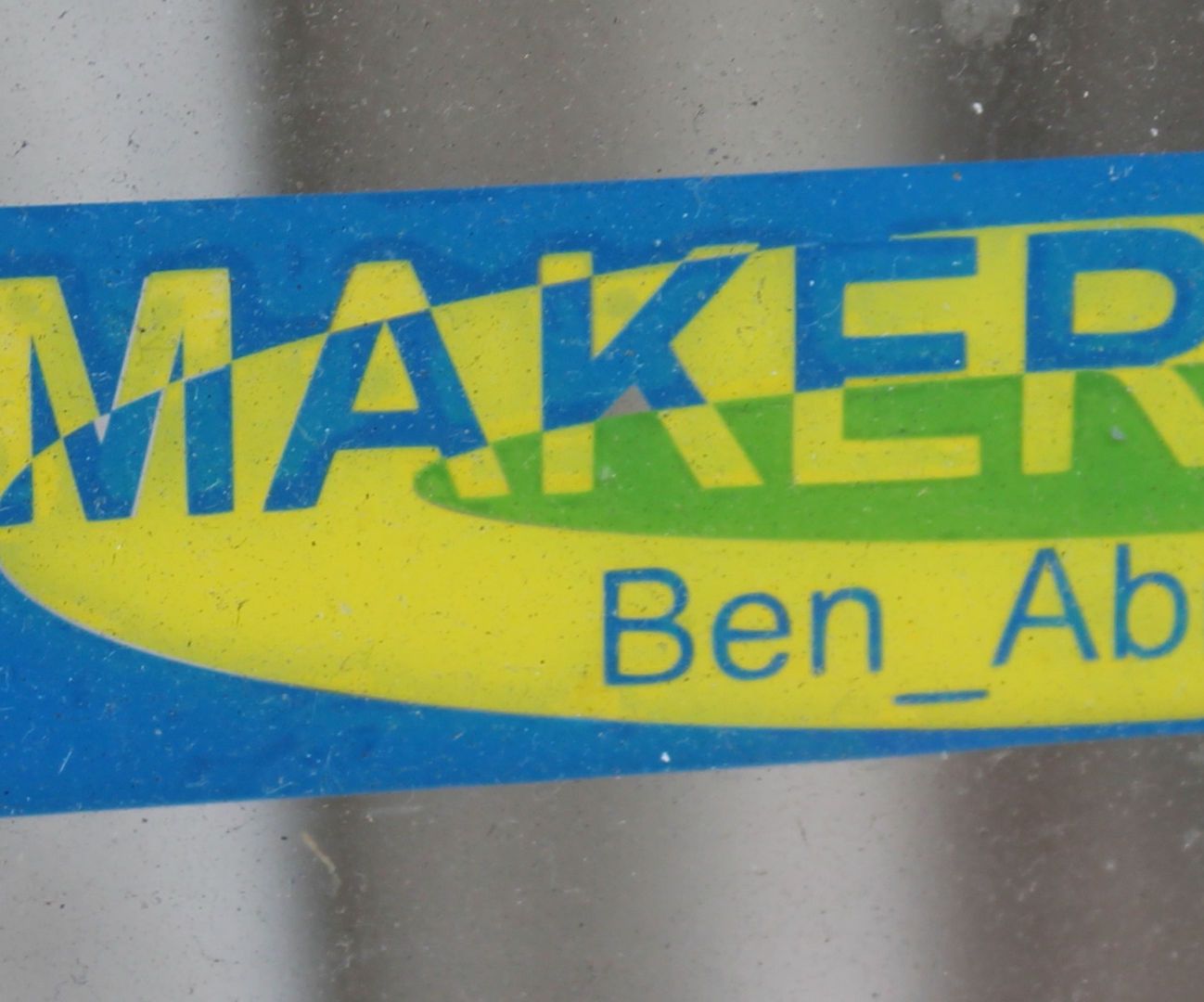

Introduction: Multi Coloured Vinyl Cutting
This instructable explains how to use the Silhouette Portrait vinyl cutter, to make simple, one-sided multicoloured stickers.

The idea is to lay several layers of different coloured adhesive vinyl on top of each other, cut through them all, and then remove the unwanted layers to expose the desired colour of vinyl in that area.

You can see with the vinyl I used (ORACAL), setting 3 got through to the base layer, and setting 4 cut through all.
I know to use setting 3 for all of the detail, and setting 4 for the boundary box around the whole sticker.
Step 4: Cut and Peel
Cut using the setting found (3 for the features and 4 for the boundary)
Using the sharp tweezers, dig into the top layer and pinch, to peel away the top layer, repeating until the desired layer is exposed.
Each time, clean the tweezers by sticking the scrap vinyl to a piece of upturned sticky tape.
