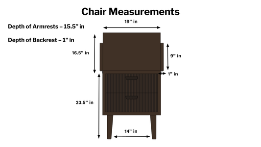

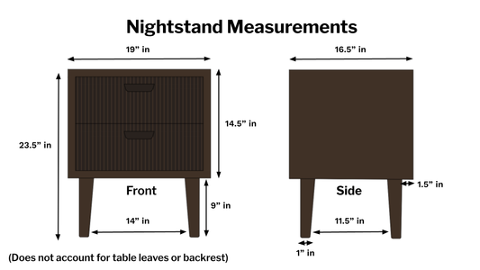

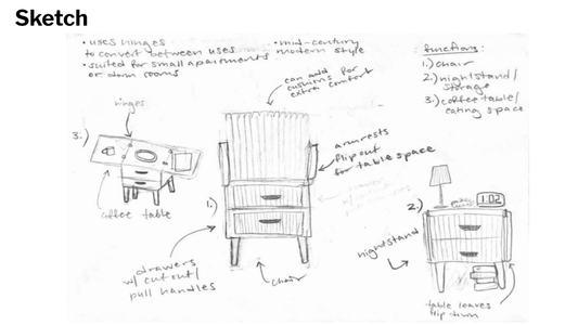

In my sketch, I drew out the basic concepts for each function and how they might look while in use. After deciding how I wanted the piece to be designed, I researched the standard measurements of chairs, nightstands, and coffee tables. I took the most average/common dimensions for each piece, while also accounting for adjustments in function. I tried to keep the piece on the smaller side so that it would be lighter for moving between rooms/places. All measurements below are in inches.
Nightstand Measurements
Height — 23.5"
Width — 19"
Depth — 16.5"
Height of Legs — 9"
Table Leaf/Armrest Measurements
Height — 9"
Width — 15.5"
Depth — 1"
Backrest Measurements
Height — 16.5"
Width — 19"
Depth — 1"

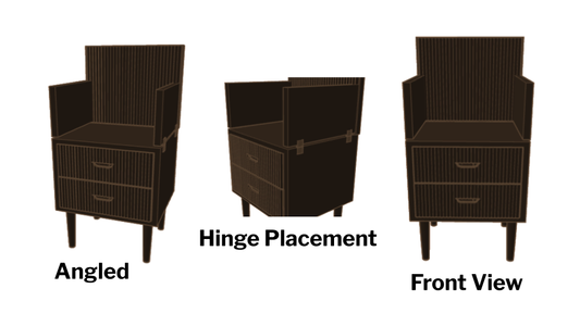

I modeled my piece in AutoCAD and TinkerCAD to show both simplicity and depth. The armrests will sit on top of the piece so that they can have full mobility. To prioritize comfort while being used as a chair, the drawers have cut-out pull handles so as not to disturb whoever is sitting down. The armrests/table leaves and backrest will be folded all the way up in this form for support.

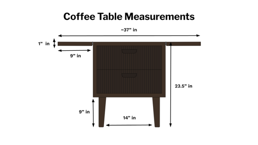

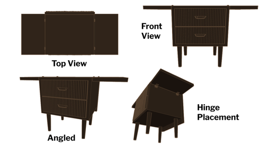

In this form of the piece, the armrests will be folded halfway down to act as table leaves/extensions, while the backrest will be folded all the way down. These two table leaves will extend the length of the piece by a foot and a half, creating a large amount of table space. This form of the piece is most appropriate for larger gatherings to accommodate for as many people as possible.

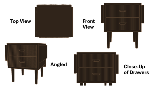

When being used as a nightstand, the armrests and backrest will be folded all the way down so that it can fit in smaller spaces/next to beds. In addition to storage space in the drawers, there is also room for storing items both on top of and underneath the piece. A mid-century modern piece like this would look great in rooms with warm lighting, natural materials, vintage items and greenery/plants.
