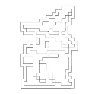

Step 2: Outlines
Now you will need to look at the image and decide how you will paint it in a series of layers. This image only has 4 colors, but it needs 5 layers. The black will be the base coat and then there will need to be another black layer on top top for the shadows of the robe.
For either method below, start a new file that is a printable size. I used 10" x 8"
I used Illustrator to trace the outlines with Live Trace. That process goes like this:
- Drop image into Illustrator
- Select Live Trace/Color 6
- Expand the trace
- Duplicate the layer as many times as layers you will need.
- On each layer, delete everything except for the color you want
- Convert all of the shapes to a black stroke with a white fill

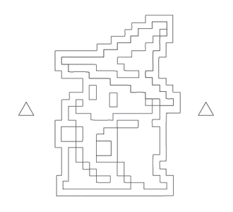

Step 3: Add Registration Marks
Registration marks are the key to making a multi-layer stencil. These let you easily align the different layers when you're painting.
To do this just add a new layer on top and create two triangles in it. One on either side of the character. The farther away they are, the more accurate they are.

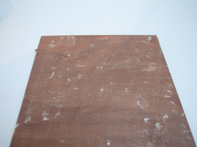

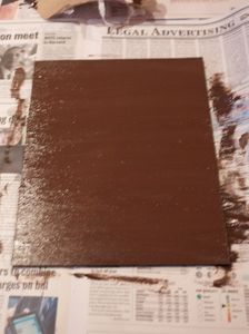

Step 5: Prep the Board With Paint and Wax
If you want to just do a regular stencil, you can skip this step. The goal here is to prep the wooden surface so that it can be easily "distressed" later.
- Paint the board with a coat of brown paint
- Rub the surface with wax. I used a block of beeswax, but I've heard crayons work, too.
- Paint the board with a coat of off-white paint

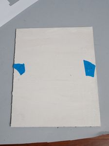

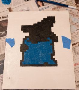

Step 6: Registration Tape
Now we'll be adding registration marks, but don't want those marks to stick around. So we'll be using some painter's tape to help out.
- Place stencil on board
- Put small pieces of painter's tape under the registration marks
- Take a black pen and outline the registration marks onto the painter's tape
Presto! You now have two registration marks that will guide your painting and won't leave a mark.

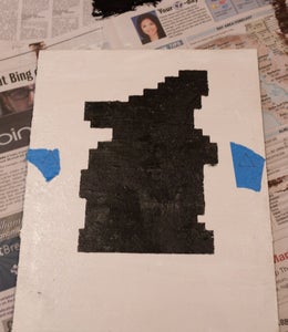

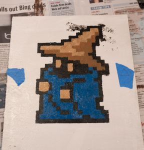

Step 7: Paint, Paint, Paint
For each of your layers, the rest is easy. Just place the stencil on the board so that the registration marks and holes line up and paint. Let that layer dry and do the next.
Want to put your character more places? Do the whole thing again!
Want a grungier look? Add some splats and drips for good measure.
That covers the painting. For distressing there's one last step...

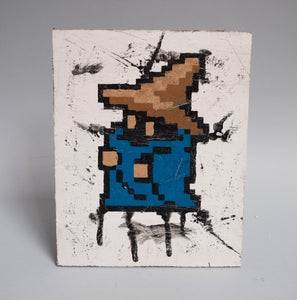

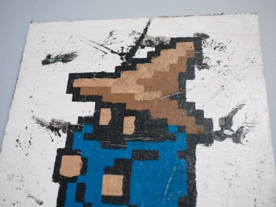

Step 8: Roughen It Up
Take some very rough sandpaper, I used 40 grit, and rough up areas where you want the paint to flake off. The places where the paint is on top of wax will have a weaker connection and come off easier. You can only subtract here so be careful not to go too far. Roughen the piece up, look at the whole thing for a bit, and then do more if you want.
That's it!
