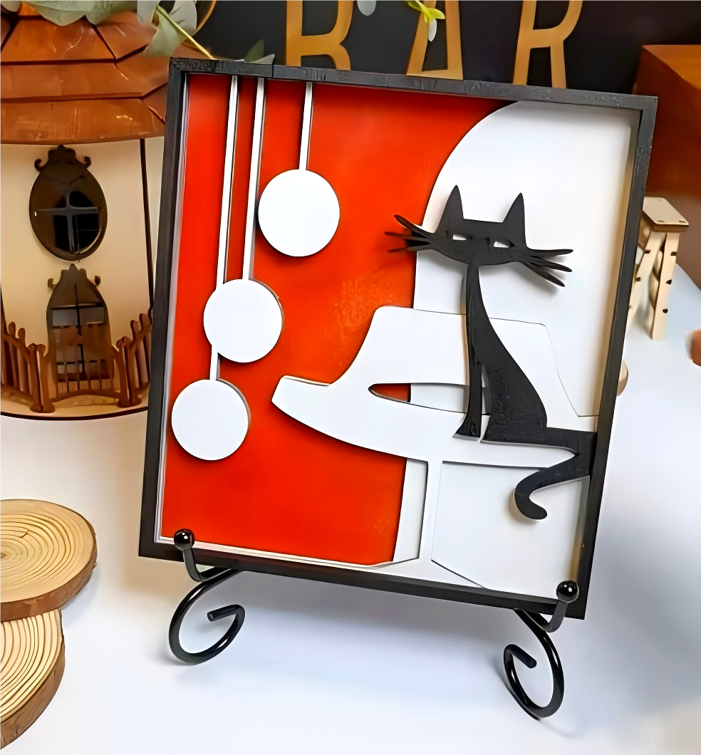

This project builds depth and dimension by stacking multiple wooden layers, reveal a cat scene when assembled. The result is a 3D wall hanging or desk decor that's perfect for cat lovers. The process involves designing, cutting, painting and assembling the layers.

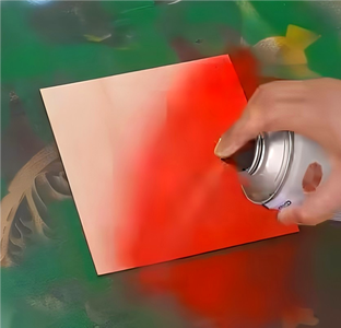

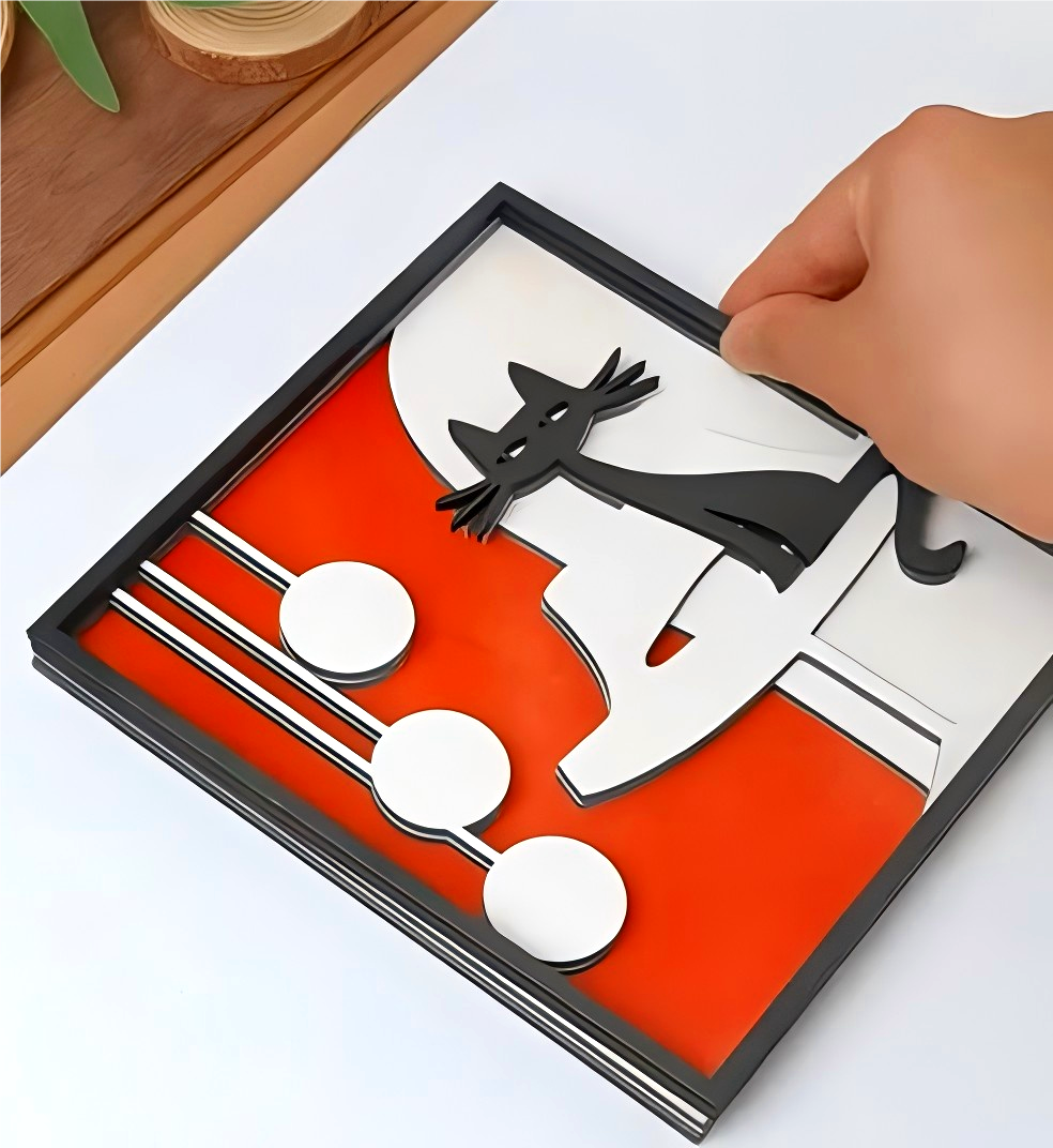

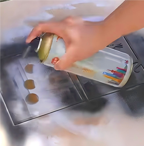

Step 3: Painting & Assembling
After cutting the wooden layers, proceed to paint them for added vibrancy. Use acrylic markers or a paintbrush for precision. Once painting is complete, assemble the layers in the order of the design, starting from the back and moving to the front.
Congratulations—you’ve now completed your stunning multi-layered wooden cat art piece!
