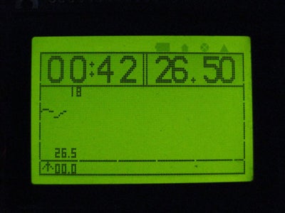

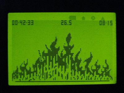

The code is written in CCS C and compiled into a hex file. It generates several graphics for the LCD screen, produces sound effects, retreives the time data from the real time clock chip and runs the menus etc for time adjustments etc.
The code uses the 1 bit sound algorithm for producing sounds without using any sound chip or DAC etc.
