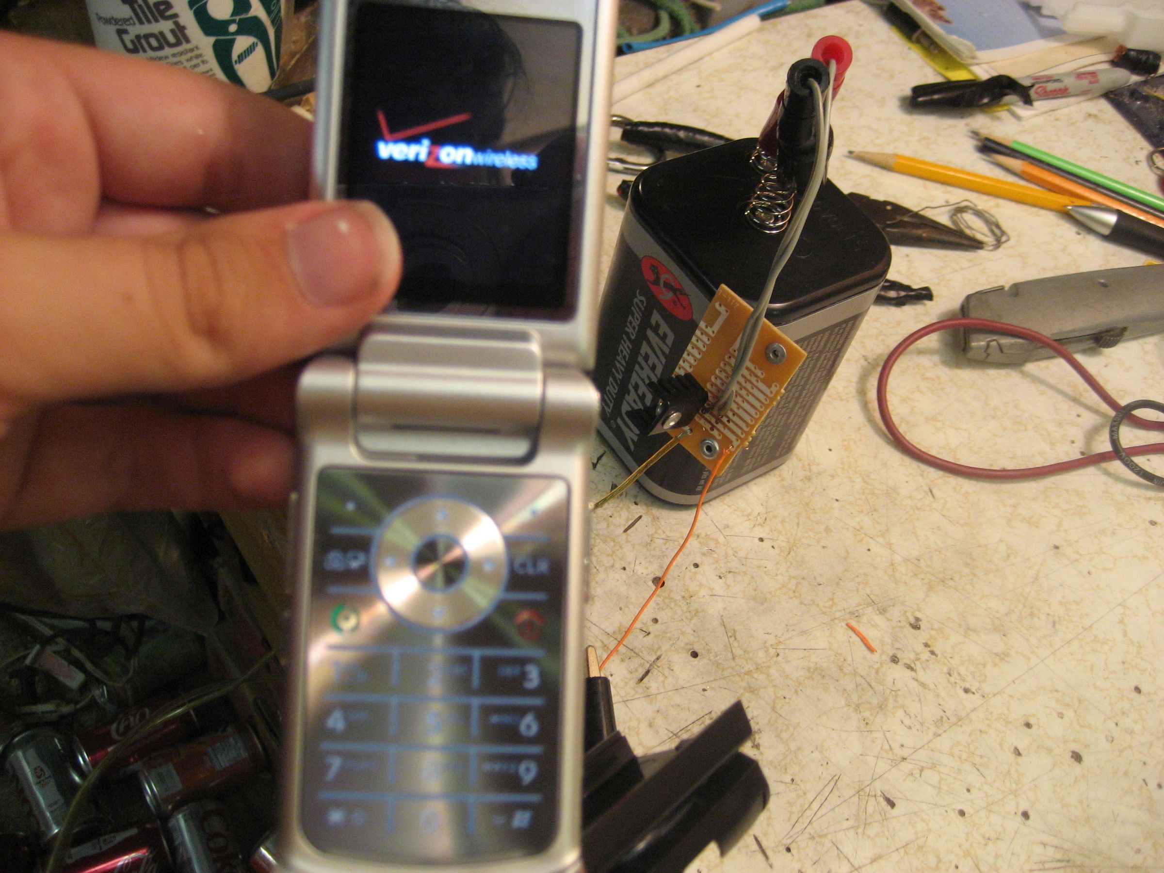

Step 8: Regulator Board
a regulator board is really easy to make, simply chose the voltages you need and put regulators on for each one.
7805 is 5v
7806 is 6v
etc...
7805 is 5v
7806 is 6v
etc...
