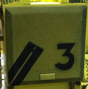

Step 6: Paint and Distressed Metal Technique
I wanted the robot to look battle scared, used and generally roboty...
> After sanding everything and cleaning off the dust I set the pieces out and coated everything black.
> Next I decided where to stick masking tape to form the shapes and numbers. The masking tape keeps the black areas untouched throughout the overcoating process leaving clean negative shapes.
> After sticking all the masking tape down I applied a single layer of safety yellow to one piece at a time. Before the paint sets I sprinkled fine saw dust from the cutting process over the still wet paint. After about 30 minutes I applied a second coat that seals the sawdust in place. Before the top coat cures I rubbed my finger along the edges to rough the paint job up. This is the easiest way to make faux metal robot paint.
> I also painted the speaker grill and cloth with a light coat so as not to impede the frequency range passing through.
> The final step was to remove the masking tape and touch up as needed...
