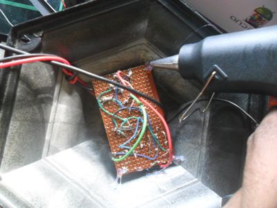

Step 2: Making the Main Circuit...
First you need to make the circuit as shown in the diagram.
in this circuit i use BC547 transistor instead of D880 because of its more sensitive than D880 transistor
if you use 2pcs of 6v solar panels wire them serial type.
The battery is self protected from discharge because a 6v relay can't turn on with less than about 6V, and it's overcharge protected because of the solar panel is about 12V 500mah , and the maximum battery voltage is about 7.4V 5000mah it can cover 10hours day time.(its well over than the real sunny day time)

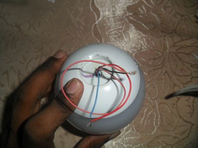

Step 3: Making the Led Bulb..
You can get 5730 smd chips from old chinese led bulb
then remove then from the circuit & solder them carefully
after that you need to add 20ohm resistor
finally attach them to the bulb casing, now the bulb is ready to use ...

Step 5: Assemble Parts to Lamp Cover & Finishing Touches...
After making all electrical items please recheck all of them before set them to the cove
then you need to add them to the lamp cover
therefor first you need to atch main circuit and other wires into the lamp cover
Then you can attach PIR sensor and bulb to it ,
After that solder the solar panel to wires
then cover all the joint with pvc tape or heat shrink tube
then add some hot glue and cover the PIR sensor for protect it from water
after that attach the solar panel on to the lamp cover by using hot glue
finally fit the cover with nut & bolts

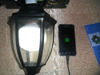

Step 6: Test and Close-up the Lamp...
After attach them all add glass plates and other decorations plug your mobile phone or any USB plug type to the
socket then you can see its charging
cover the solar panel & move any thing near the PIR sensor then you can see blue leds start to flash and after short period they turn off
then you can assemble it in a any place you like by using a pipe...
