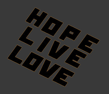

Everything starts with a "LOVE" and from there I start to make minor modifications like "LIVE" then "HOPE" and from there I simply limited the views of each piece and how to organize them so that they were congruent with the desired texts, avoiding repeat letters but taking advantage of the functionality of letters like the "M" which, by turning it, can work like a "W"

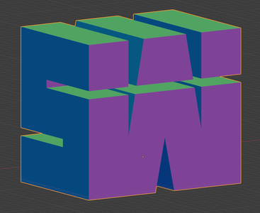

Step 5: Blender Operations 1

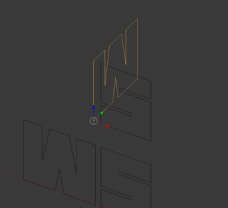

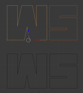

After choosing the font that we will use from the editing program where we are, we will save it in SVG (Scalable Vector Graphics) format which we will import into Blender. Below you will find screenshots of two versions of Blender, and you will wonder why? I work with 2 versions since sometimes the results of the boolean modifier can vary, so I always stay with the most optimized and functional results for subsequent steps.

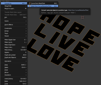

first of all import the svg file, then convert it to mesh from curve as indicated in image 2
then locate the faces of the letters in the best possible way and so that there are no structuring conflicts in the bodies of each letter and at their intersection, you must review very well.

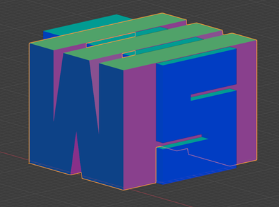

Step 6: Blender Operations 2
Then we will apply the boolean modifier to any of the two letters and in the modifier object options we will drag the dropper to select its counterpart, that is, the missing letter to generate the space difference.

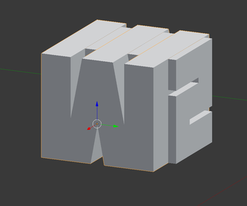

Step 7: Blender Operations 3
To finish, do the same process for the remaining letters.
Keep in mind that it is always good to first place the pieces in the best possible way to blend together, so that the letter seen from the front looks as natural as possible.
After that you will get 6 pieces with 12 different views.
