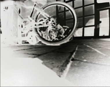

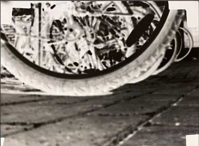

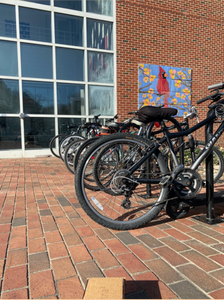

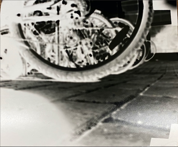

Once your camera is built, you must load your photo paper into it and decide on a subject. It is important to load the paper in the dark room so there is no risk of exposing it to light. Decide what focal length you want to utilize and place your paper into the corresponding slot. Ones where the photo paper is further away from the pinhole (or at the back of the camera) will appear more zoomed in. Next, head outside and pick a subject matter you want to capture. Natural light from the outdoors creates much more desirable exposure times compared to indoor spaces.
Hold your camera very still and remove the covering from the pinhole. After your desired amount of time has passed, quickly replace the covering over the hole and bring your camera inside. The exposure times will vary depending on a variety of factors, including distance of the paper to the pinhole within the camera, and the strength of the sun. For example, our first attempt used a 15 second exposure time when it was very sunny and the paper was in the slot furthest away from the pinhole. When we moved the paper one slot closer to the pinhole but in the same weather conditions, the exposure time was only 5 seconds. It may take some trial and error to determine the perfect exposure time for your conditions.
Step 7: Develop Your Photos
Once you have captured your subject, bring your camera and photo paper into the dark room. Be sure not to open the lid until you are in the darkroom, as to not risk exposing the photo paper to any light leaks. Next, place your photo paper in the Developer for the designated amount of time (about 2 minutes). At this point, you should start to see your image appear on the paper. Move it to the Stop Bath to stop development and leave it in there for the designated amount of time (about 30 seconds). Then, move it to the Fixer and let it sit for the designated amount of time (about 2 minutes). Finish the process with a water wash for at least 5 minutes before bringing the photo paper out into the light.
Once the process is complete, place your image on a drying rack and wait for it to dry. At this point, it is safe outside of the dark room. This is a good opportunity to evaluate any additional changes that may need to be made to exposure times and to compare the difference in results for the various focal lengths. As you can see above, the images (going from left to right) become more zoomed out as the photo paper was moved closer to the pinhole. All of the images will also print inverted in their color schemes.
