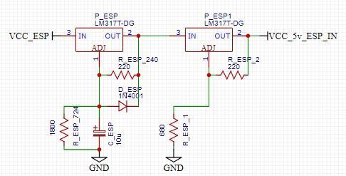

Step 11: Powering the ESP32
Herewith an inspiration to build a stand alone powersource for your ESP32, if you dont have one lying around.
The power circuit works of a 19V laptop power supply. This asks for a two phased voltage step down to keep the Power dissipation of the LM317's under control. (Even with heat sinks!). Also dont forget to inlcude a 100uF capacitor in front of the VCC_ESP line as those microcontrollers have large current swings certainly when starting up the WiFi connection.
Note to not power the ESP32 with more than one power source at a time!
