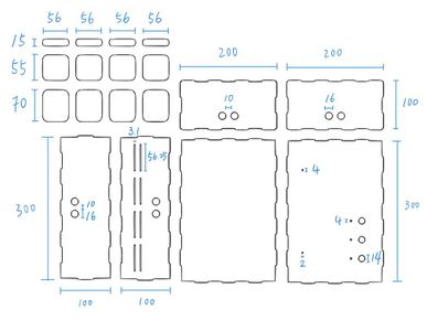

Step 1: Cutting the Box
Please download the model by clicking on the file below.
  • If you would like to make the box out of paper or plastic board, please see the photo for the scale (add a hole on the left side for the USB cable).
Step 2: Gluing the Box
  • Wood glue is recommended, but a glue gun can be used as well.
  • You can use paper tape to help fix it.
